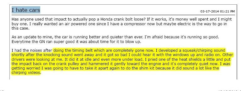

I assume the dealer used OEM parts. If not, could be water pump (Lots of fake timing belt kits even from Amazon as seller. My waterpump had many cosmetic pits in the alloy that were not on my original part. Everything else looked OEM so I finally decided to keep it.)
One poster in the timing belt thread had what could be similar issue. In his case, he fixed it by retightening the harmonic balancer. Maybe that will help.
Timing belt thread

Lbeyy,
Ignore yellow highlighting in the attached images in my last post. The highlighting was made for another project.
