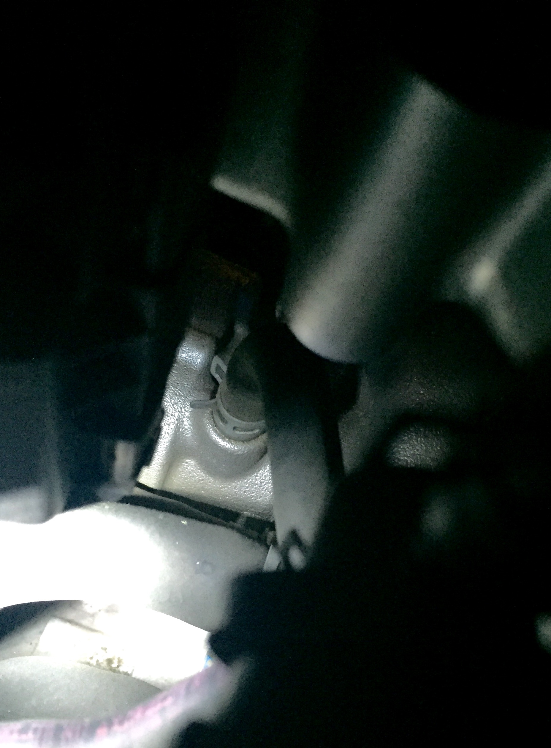

Ok so I was getting a whistle sound when the car shifts and a certain RPMs
I was reading and then popped to hood to see these are connected to anything, I looked in my Haynes Manuel and it doesn't show what it connects too
Anyone have a picture of there's so I can route the hose in the right area, and hopefully get rid of this whistle noise

It's right under the throttle body, one has a cap the one behind it doesn't, idk what this previous owner was trying to do, a lot of things on this car is rigged up

That's your TB coolant bypass.
https://acurazine.com/forums/perform...dy-cai-602346/

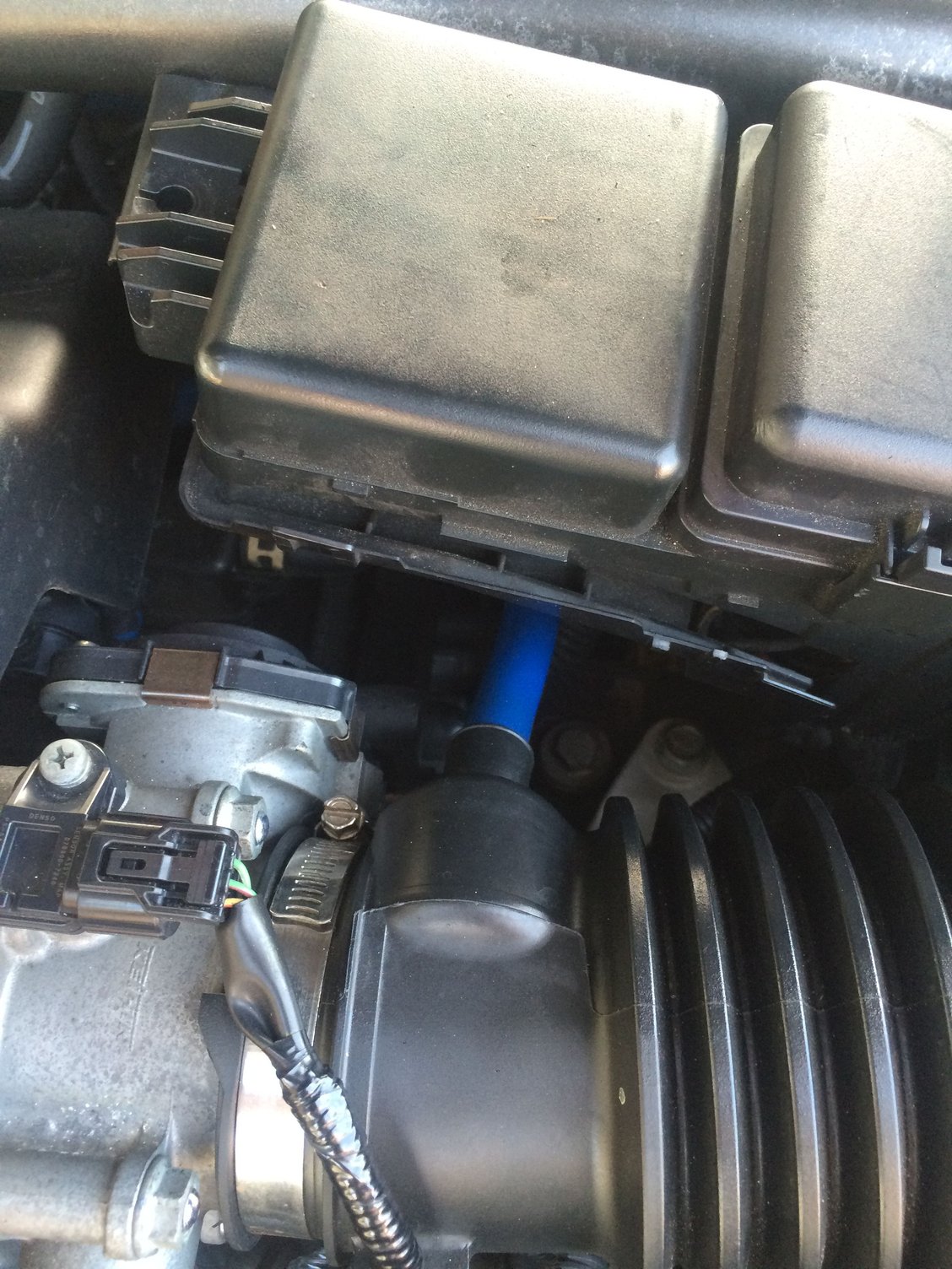

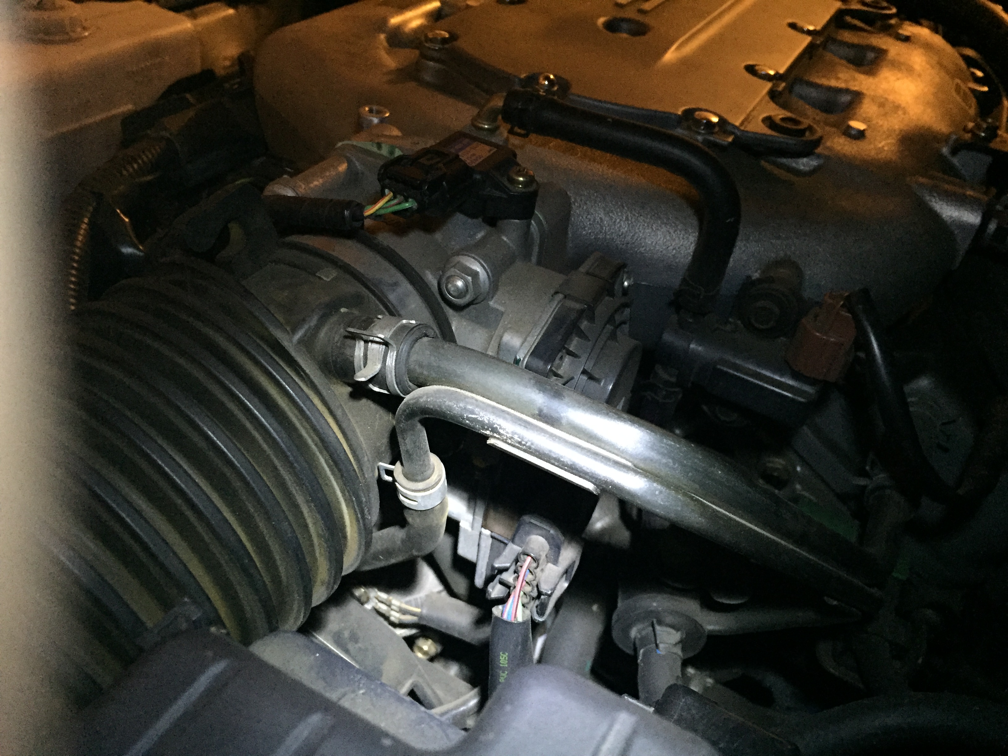

And for reference here is what it looks like stock...

It connect from the throttle body to hard line that loops back to the upper rear intake manifold...
I'm guessing you have an aftermarket intake?...

Nothing after market, just a k&n air filter but stock everything, idk what this dude was trying to do, maybe he put a block on it so nothing comes out?

He did the same thing ,but instead used the stock intake tube rather than an aftermarket tube. Did you read the thread I posted?

so you think that begin off has nothing to do with a whistling sound that im getting at certain rpms?

Tb coolant bypass will not make any whistling sounds. This car is known to have a little bit of whistling when it's got an aftermarket intake.

okay good, cause i keep finding problem after problems with this car,
i only have a k&n filter but in the intake box and everything is stock,
i was just reading that it is a tranny problem so i freaked
guess i should just drown it out with music
