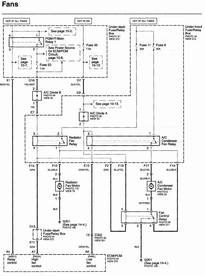

Here's the wiring diagram for the fans on 2005 TL. Start with the with the obvious stuff: fuses, powers, and grounds.
FYI, the AC fan might not turn on if there's an issue with the AC system.
