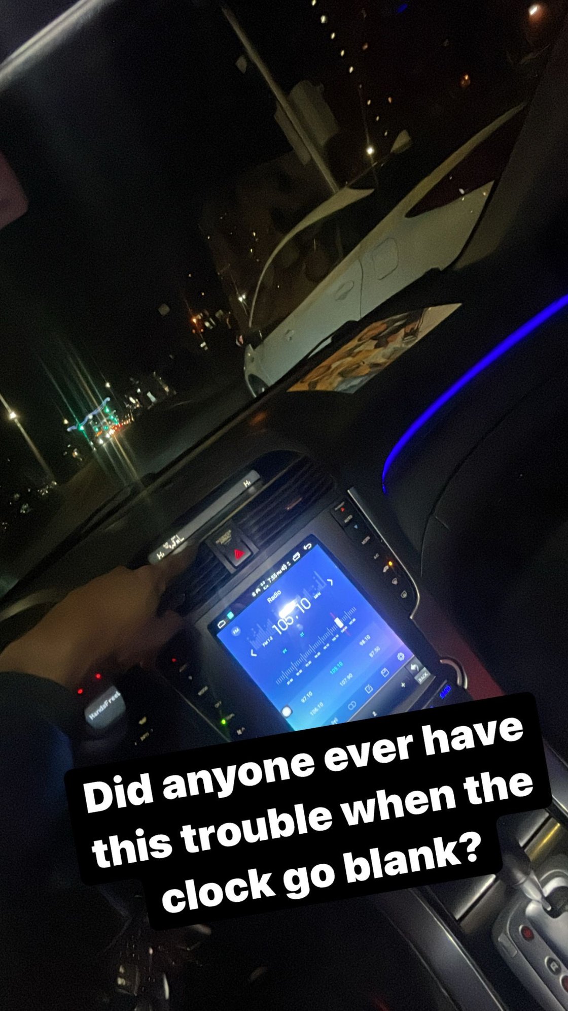

Need help fixing my clock
My clock went blank

I have a 2006 with Navi but I installed the Tesla screen and maybe a week later the clock went blank. I was wondering if there a fuse or something

2004-2006 TL clock with navi is broken due to bad programming after 2020... Install the 2007-2008 dvd drive to get the clock back or sit without a clock. As soon as the battery looses power and then tries to get the clock/time back it'll be blank or show 00:00.
some folks have had luck pulling the radio/navi fuse at 11:59 and plug back in at noon so clock shows 12:00. My 04 did not do this though...
