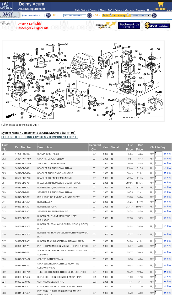

I would say replace the front and sides only bc it does most of the work, unless you see visible damage at the rear.

Do you know if the Front and Rear Mounts are the Same Part/Same Fit?

No, frt/rr do not have same PN. See #8 & 12.
Side mounts #11 & 15.
