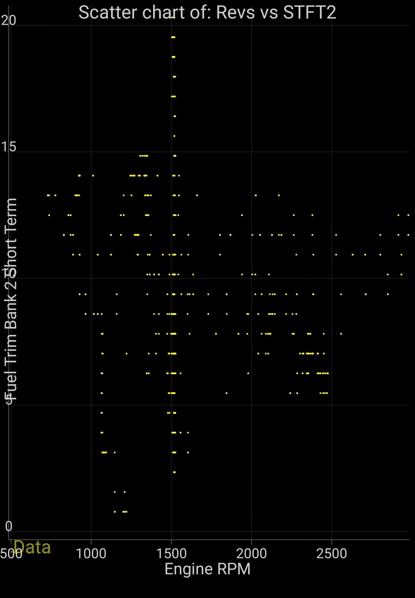

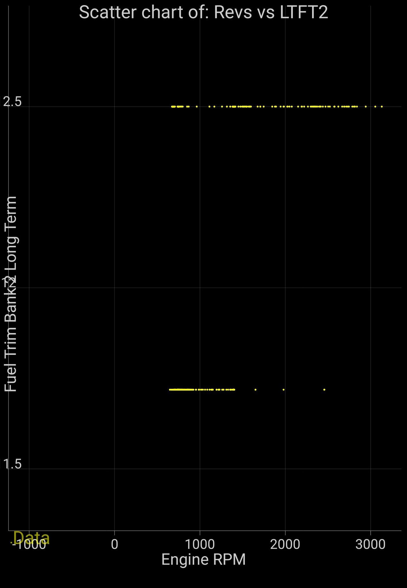

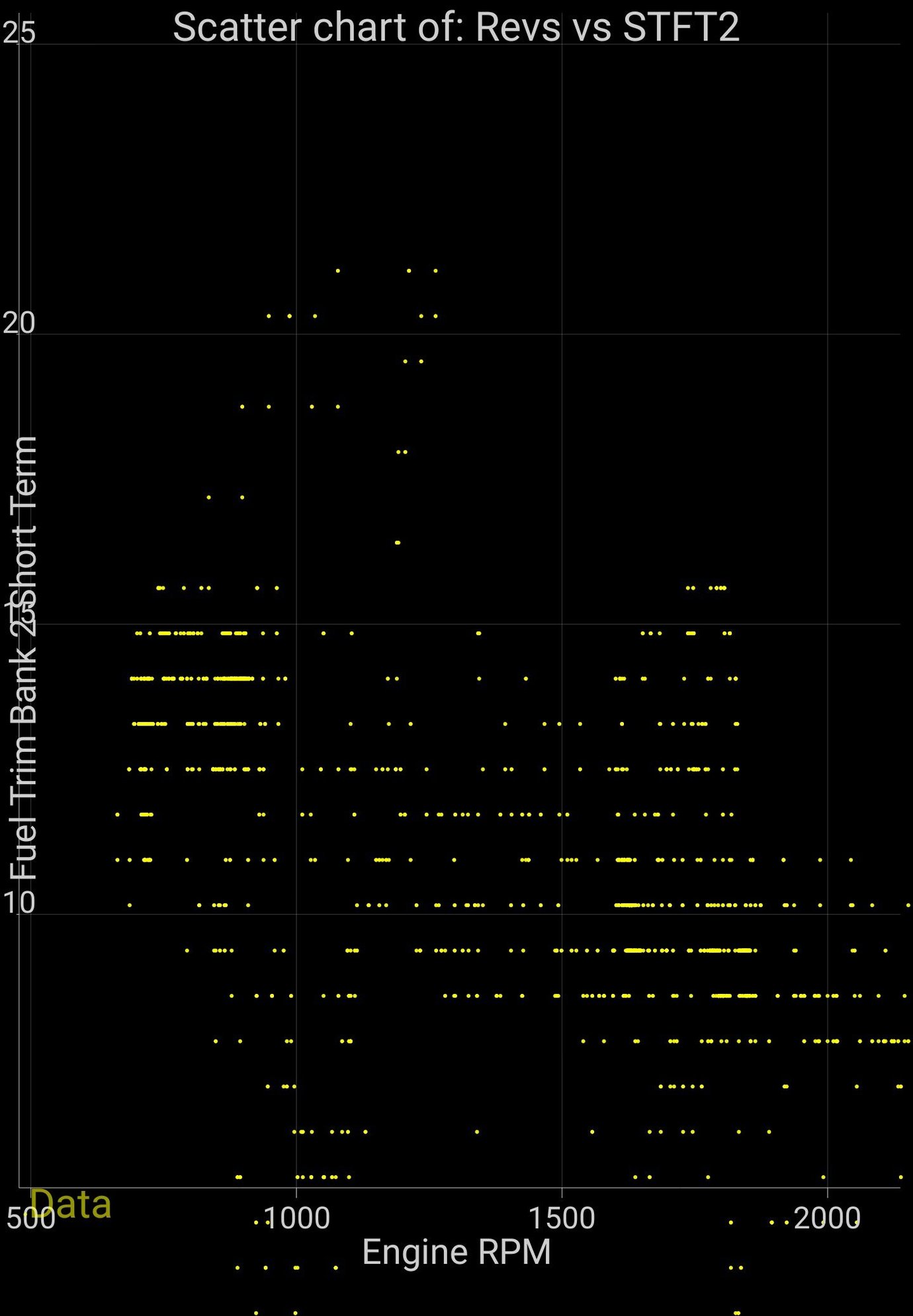

So i have the images of the Charts for RPM vs LTFT2 and RPM vs. STFT2
i also took a video of some sounds under the hood that are happening that i think are coming maybe from Valve's or lifters but im hoping someone knows what it is. I also dont see a pattern in the graphs.
RPM vs. STFT2
RPM vs STFT2 (try 2)
RPM Vs. LTFT2

Hmm, seems OK, bit of a wide scatter at 1500rpm. Video sounds OK to me but hard to tell.
Do you know if your local gas stations use ethanol blends in the fuel?
How often do you set the code? Do you have torque data when the engine sets the code and runs rough? What does the AFR measured say on torque?
