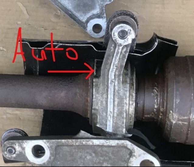

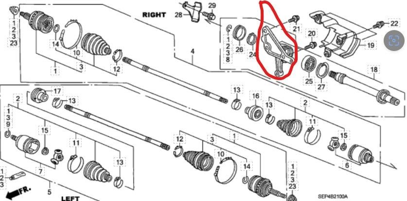

Is the 'bracket' you are referring to the one circled below?
I doubt there is a difference based on how many car fitments are associated with 44500-SJA-000.

As shown above & below, 44500-SJA-000 fits your Automatic 2007 Base TL and has the curved 'flange':

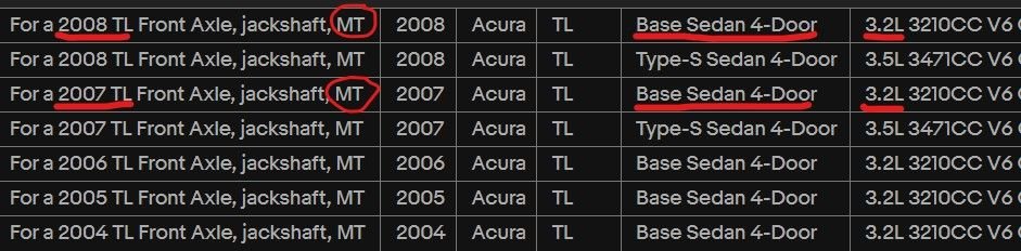

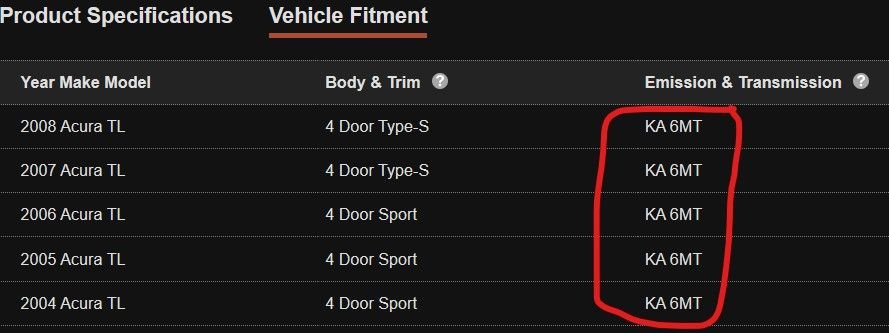

This one appears to be for a 07-08 TL-S six speed manual transmission 44500-SEP-A00 because it has a straight 'flange'?
Proof #1: link from OEM vendor; first picture for 44500-SEP-A00 shows a straight 'flange'.
44500-SEP-A00 Genuine Acura Cv Intermediate Shaft (acurapartswarehouse.com)
Proof #2: Ebay link shows 44500-SEP-A00 with a straight 'flange'.
04-08 ACURA TSX MT MANUAL 6 SPEED HALF SHAFT AXLE JACKSHAFT 44500-SEP-A00 OEM | eBay
However, the ebay listing shows an 'error' in fitment for a manual transmission 07-08 Base TL.
The problem is that the 07-08 Base TL only came with an automatic transmission as displayed in my post #2 above.
