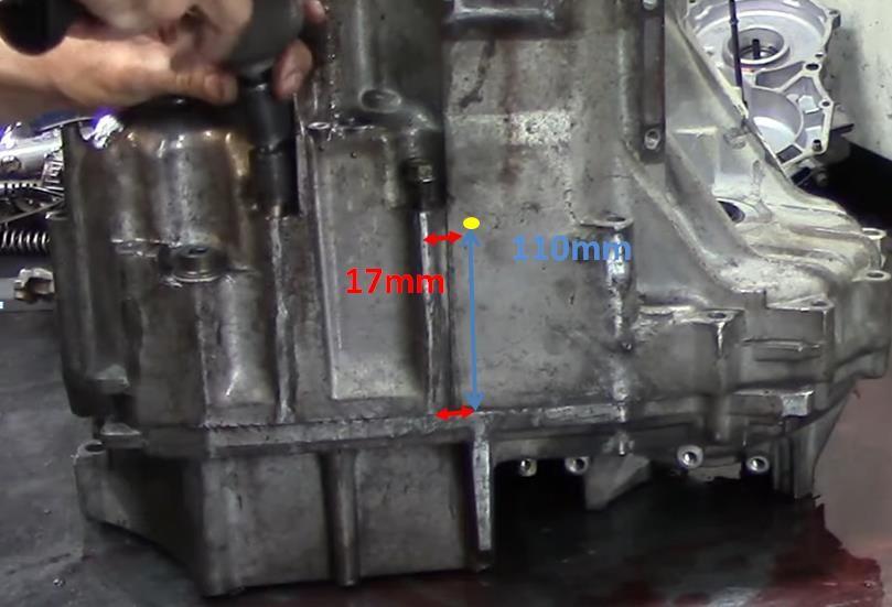

3. Mark the new access hole’s location on your transmission. Drill a small (say 2mm) pilot hole paying attention to be perpendicular to the bottom surface (fluid is going to start leaking – put the shop-vac to it and suck out the fluid – suck it for a minute). Drill a slightly bigger hole (5mm), and finally finish with your pre-tap drill size (for M10x1.5, use 8.5mm). Drill carefully each time to just put the right size of hole – control your depth! Make sure that shavings from the drilling are dropping on the ground (that you do not introduce them into your transmission) – drill slowly. Use your shop-vac to collect even more shavings as you drill. After you drilled your pilot hole, transmission fluid will start dripping. You can use your shop-vac to suck out transmission fluid through the hole. If you marked it right – your hole should be right below the suction orifice of the filter, just below the filter screen.
4. Slowly and carefully drill through the access screen/filter. When you reach into the hole with a smaller drill bit/screwdriver, you should feel the soft material of the filter. Use your shop-vac when trying to remove as much of this as you can. Use a pick. You need to do this with a feel. Use your shop-vac generously.

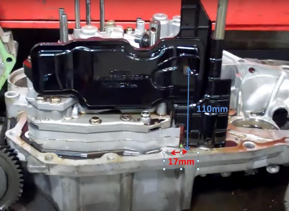

Finally, the hole’s location: it should be 17mm towards the rear of the car from the center of the second bottom bolt (has a round channel on the casting) and 110mm towards the left of the car from the line where the two transmission case parts meet. While this hole location worked for me, a more precise location could be acquired by all of you who are doing this - chiming in (say: I think it was 2mm more to the right would be better). See picture:
