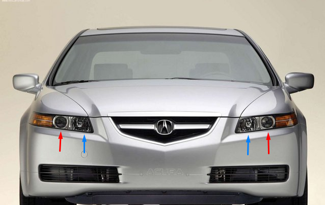

Just to make sure we're on the same line of thought, you mean the bulb pointed out by the red arrows on the driver side doesn't work anymore, is that so?
The blue arrows point to the DRL/fogs.
The low and high beams on the Acura TL is special as it does not use twin filaments or two bulbs but rather only 1 D2S bulb for both low and high beams. The bulb is always lit at 100% but the height of the beam is controlled by a shutter-type device.
If the fog light works fine, then it's most likely the D2S bulb. They're not terribly cheap but not incredibly expensive either considering their life expectancy. Changing it requires either removal of the bumper (looks daunting but isn't so horrible once you do it once) or going through the wheel well and bending your arm in weird fashions.

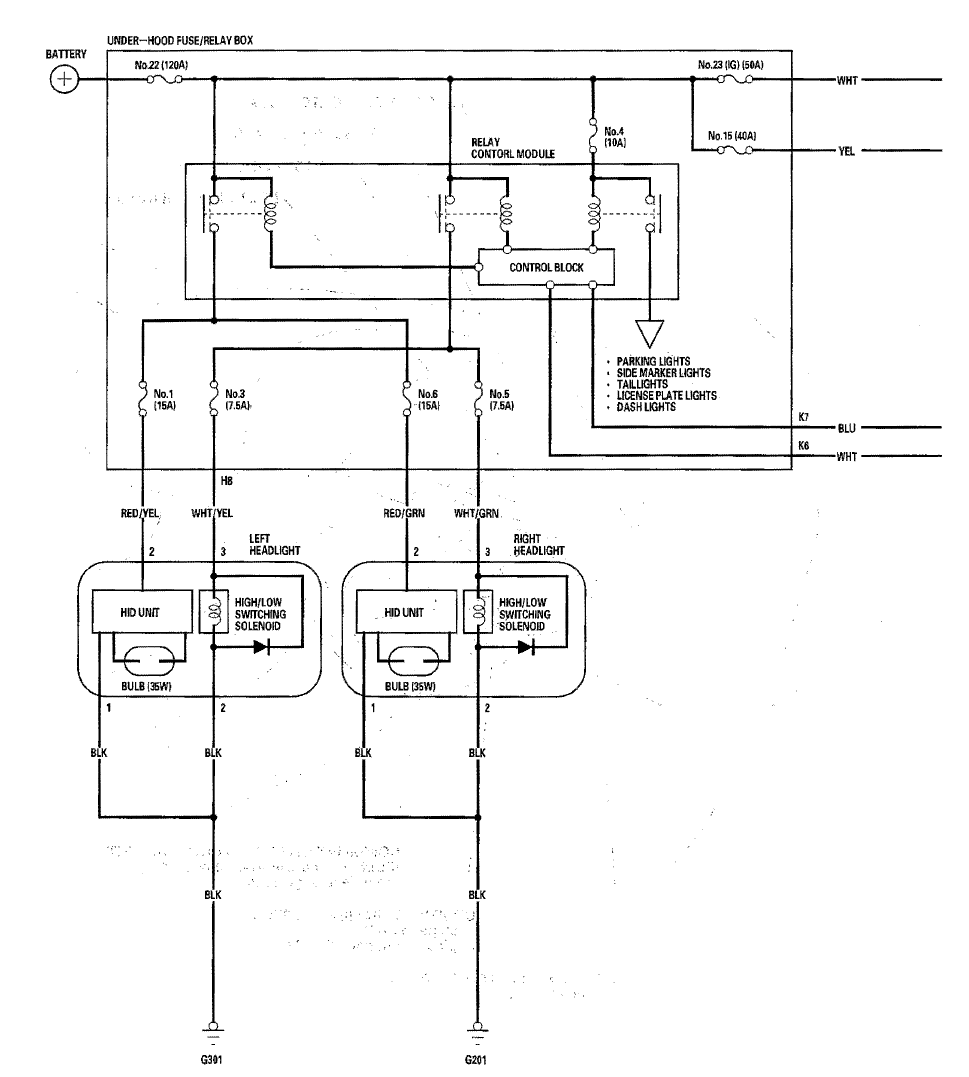

Make sure fuse 1, 3, 5 and 6 are good under the hood as per the service manual (mostly 1 and 6 though)
If they are, the first step in diagnosing the HID is to try another build.
