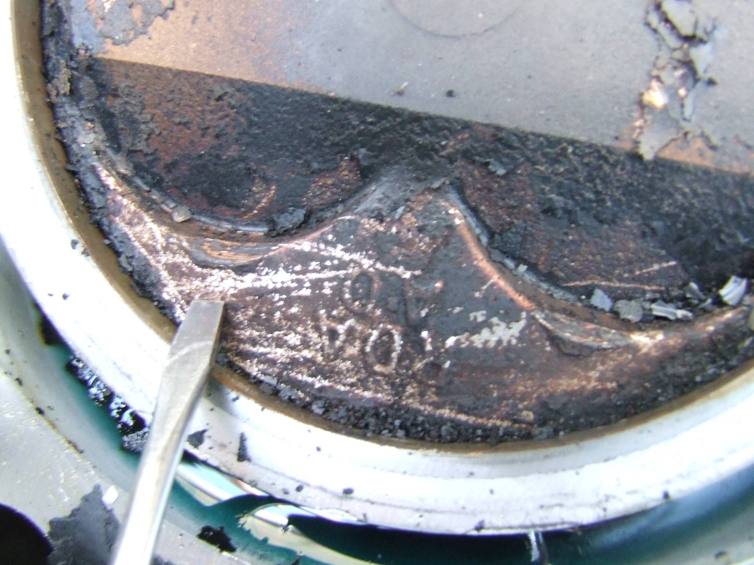

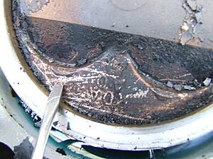

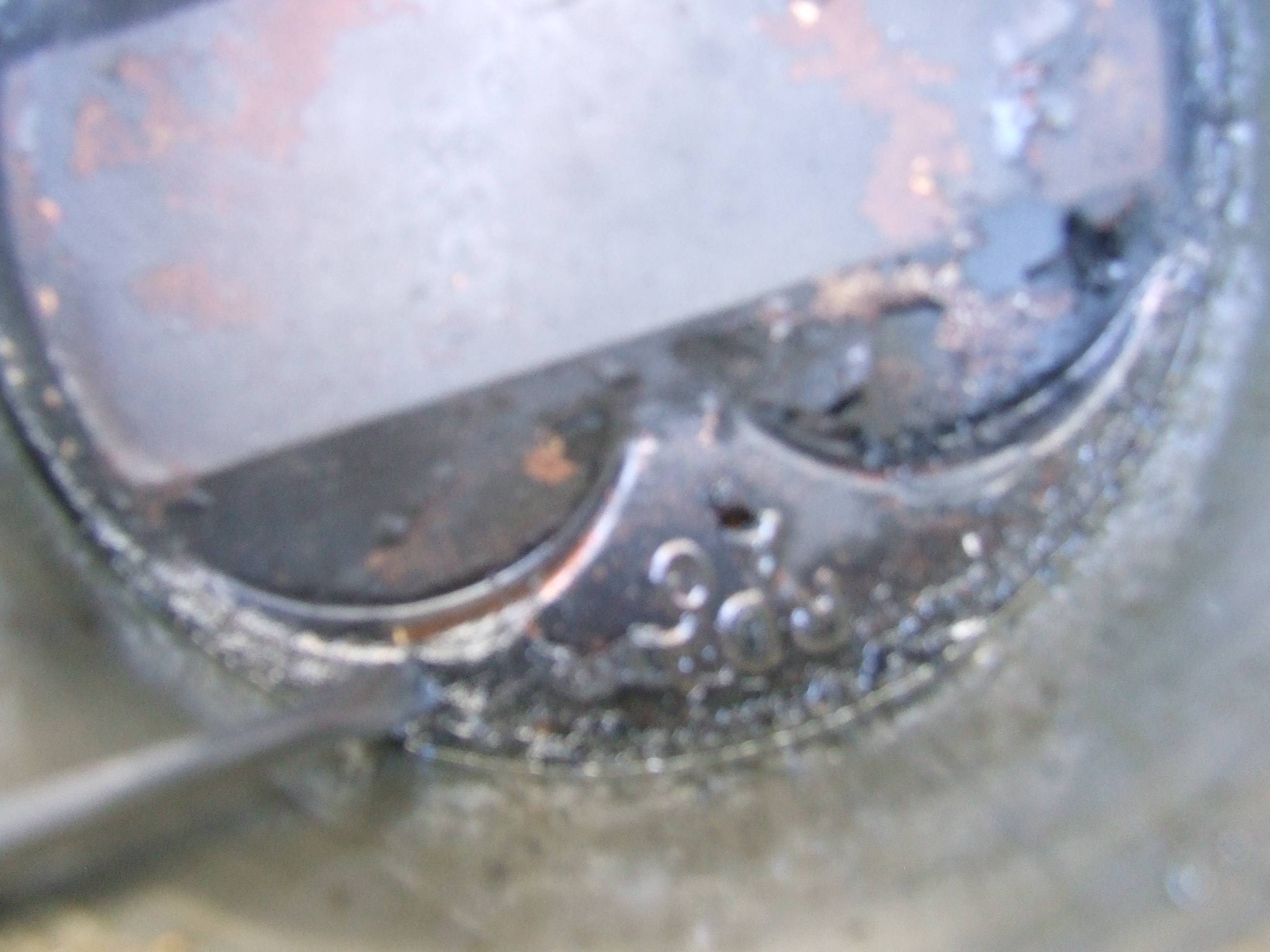

Old Jan 13, 2012 | 04:21 PM
cosmos13's Avatar
Joined: Dec 2004
Posts: 77
From: CA
Pics
Picture from dealer and explanation.
http://imgur.com/AGDRZ
http://imgur.com/K2wP8
http://imgur.com/7SQFr
here are pictures of the top of the pistons where they physically have collided with the exhaust valves. The tip of the screwdriver is there to point out the half moon shape in the top of the piston.
Old Jan 13, 2012 | 04:54 PM
CLtotheTL32's Avatar
Posts: 36,803
Likes: 9,625
From: Charlotte
Wow. So what are you going to do?
Old Jan 13, 2012 | 04:55 PM
swoosh's Avatar
takin care of Business in
Posts: 30,994
Likes: 4,733
From: Kansas City, MO
lemme help you:
Old Jan 13, 2012 | 07:36 PM
Acura_Dude's Avatar
David_Dude
Joined: May 2011
Posts: 13,283
Likes: 581
From: Florida
OMG this really happens? So let me get this straight, over time the plugs actually back out of the head? What causes that? Just simple compression? Is this actually normal?
Old Jan 14, 2012 | 10:55 AM
swoosh's Avatar
Posts: 30,994
Likes: 4,733
there was a thread somewhere which mentioned check ur plug every 60K miles.....as they tend to back out....
