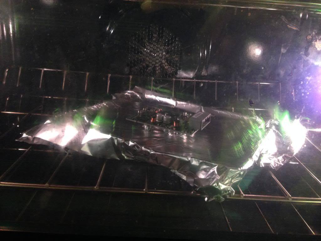

Old Sep 17, 2015 | 09:41 PM
jeedo6's Avatar
7th Gear
Joined: Apr 2015
Posts: 7
I actually pulled the board out of the black jacket and stuck it in the oven. 385F for 8 minutes followed by a 25 minute cool down. I then inspected for any damage caused by the baking and found none visible. Threw it all back together and in the car and now it's working again like a brand new. don't wast your $600 at the dealer for a replacement
Old Sep 18, 2015 | 04:19 PM
eastcoastguy's Avatar
Joined: Nov 2012
Posts: 676
Likes: 110
From: Springfield, MO
Not to burst your bubble, but wait a few weeks and see if it still works. I think everyone that has baked their HFL got it to work for a few weeks and then it died again. Hopefully by some stroke of luck yours will work. GL!!
Old Nov 6, 2015 | 12:49 PM
Justin Olson's Avatar
Joined: Apr 2006
Posts: 13
From: Cincinnati, OH
Baked mine at 385 for 9 minutes, works great.

Old Nov 10, 2015 | 03:24 PM
P1zzaman's Avatar
Joined: Jun 2008
Posts: 1,653
Likes: 201
From: San Mateo, CA
Thanks
What exactly happens when you bake it? Is it some soldering that needed to be remelted or something?
Old Nov 10, 2015 | 08:48 PM
truonghthe's Avatar
Joined: Jun 2008
Posts: 7,967
Likes: 1,702
remelt the soldering, after years of usage the soldering they use is "lead free" eco friendly substances. These early generation "lead" solder type develop micro crack over time and cause it to fail. Same concept as earlier Xbox 360 ROD and PS3 YLD. The baking process call reflow, other method call reball.
