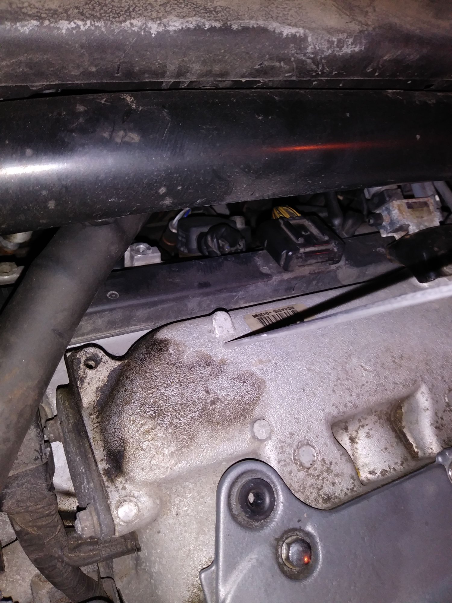

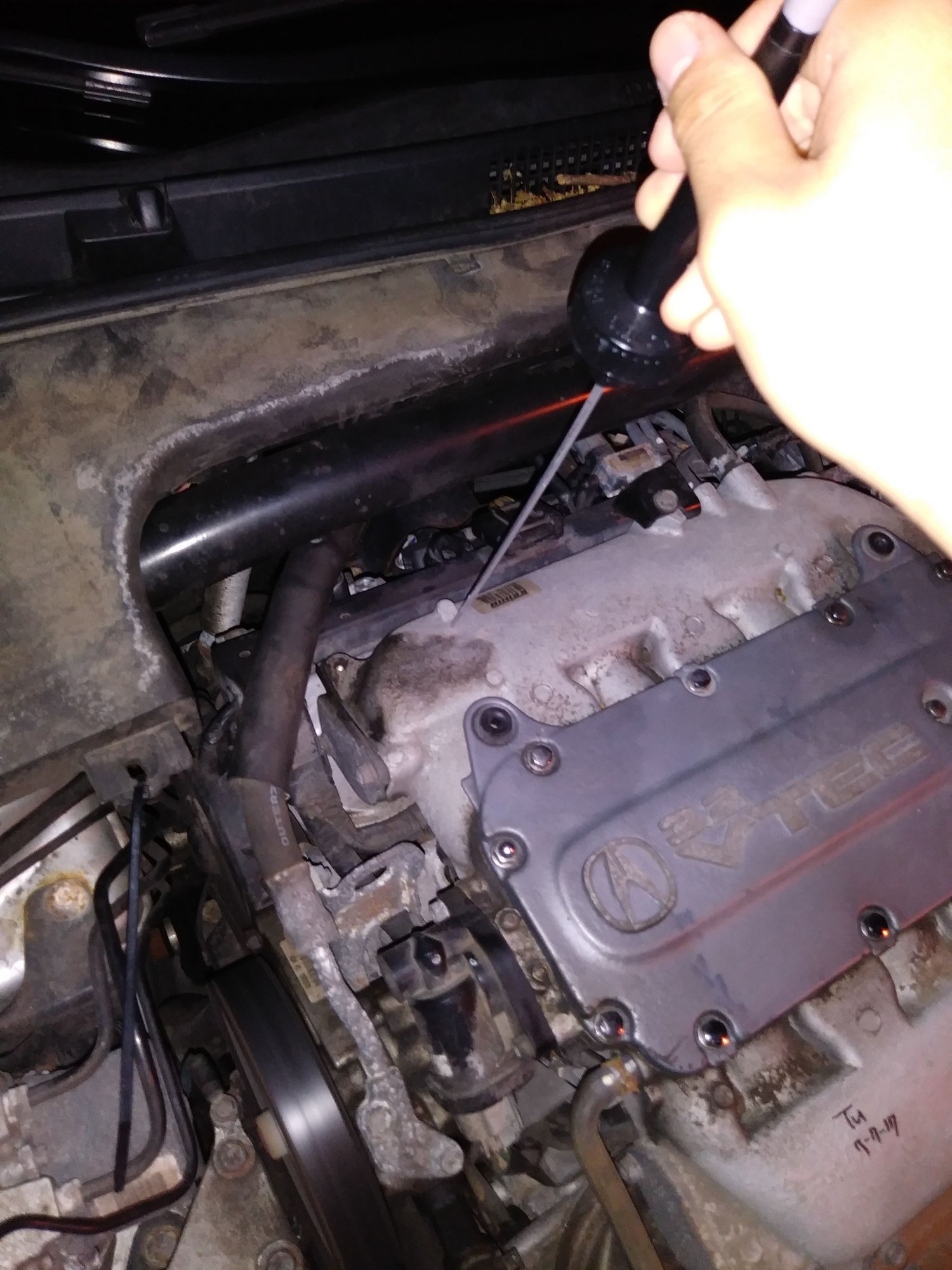

@Crashmaster, @Octanee, & @horseshoez
Just received the stethoscope earlier today but was unable to use it until not too long ago. I wasn't able to 100% pinpoint where the knocking/ticking is originating from but I am aware of the general area. It's currently too dark outside so I wasn't able to maneuver too well around the engine bay, so will try again in the morning or if requested. I took two pictures to give a general idea of where the knocking sound is coming from. Any suggestions would be great at this point, thanks!
This is the zoomed in picture of where the sound is most easily heard.
This is to give a better idea of where the sound is originating from, where the tip of the stethoscope meets with the engine.

I have to assume that the Acura tech performed the valve adjustment correctly without noticing anything obvious. So in the area you pictured, what could cause the ticking sound? My best guess would be a broken valve spring. My suggestion would be, is to return to the Acura dealership and allow them to repair it. They should give you some consideration on a further repair because you were just in last month.

Checked and tightened all spark plugs today.. everything checked out okay. If it's any new information, I started smelling a burning plastic smell coming from under the hood, not sure that it means that much though..
I plan on taking the car for another engine diagnostics at a certified Honda dealership that I have worked with in the past (very reliable and honest people) to get a second opinion.
If a valve were to be broken, I wonder why the service technicians didn't bring anything up. They were so good at adding on to my "estimated bill" to fix my car in the past.
