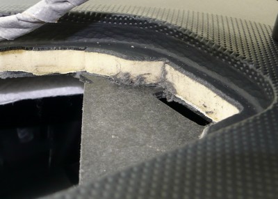

The TL dash has a a different material/texture on the driver's side compared to the passenger side. The driver's side looks/feels great - it has a dimpled texture, which gives it a two-tone type of appearance. This pic (which I took while removing the center speaker) reveals the texture quite well:
Anyway, while removing the speaker, I may have scuffed it a little, and now I want to clean it. Do all the various posts on the topic of dash cleaning (of which there are many!) apply equally to both sides? The left side feels extremely soft and rubbery, while the right side (passenter side) feels more like traditional vinyl.
Also, as attractive as the textured finish is, it wreaks havoc with visibility when driving in the sun at midday, so I'm looking to make this area as dull as possible - no shine at all. The general consensus seems to be that 303 Aerospace protectant is a great finish that does not have a shine. Is this recommended for this area?
