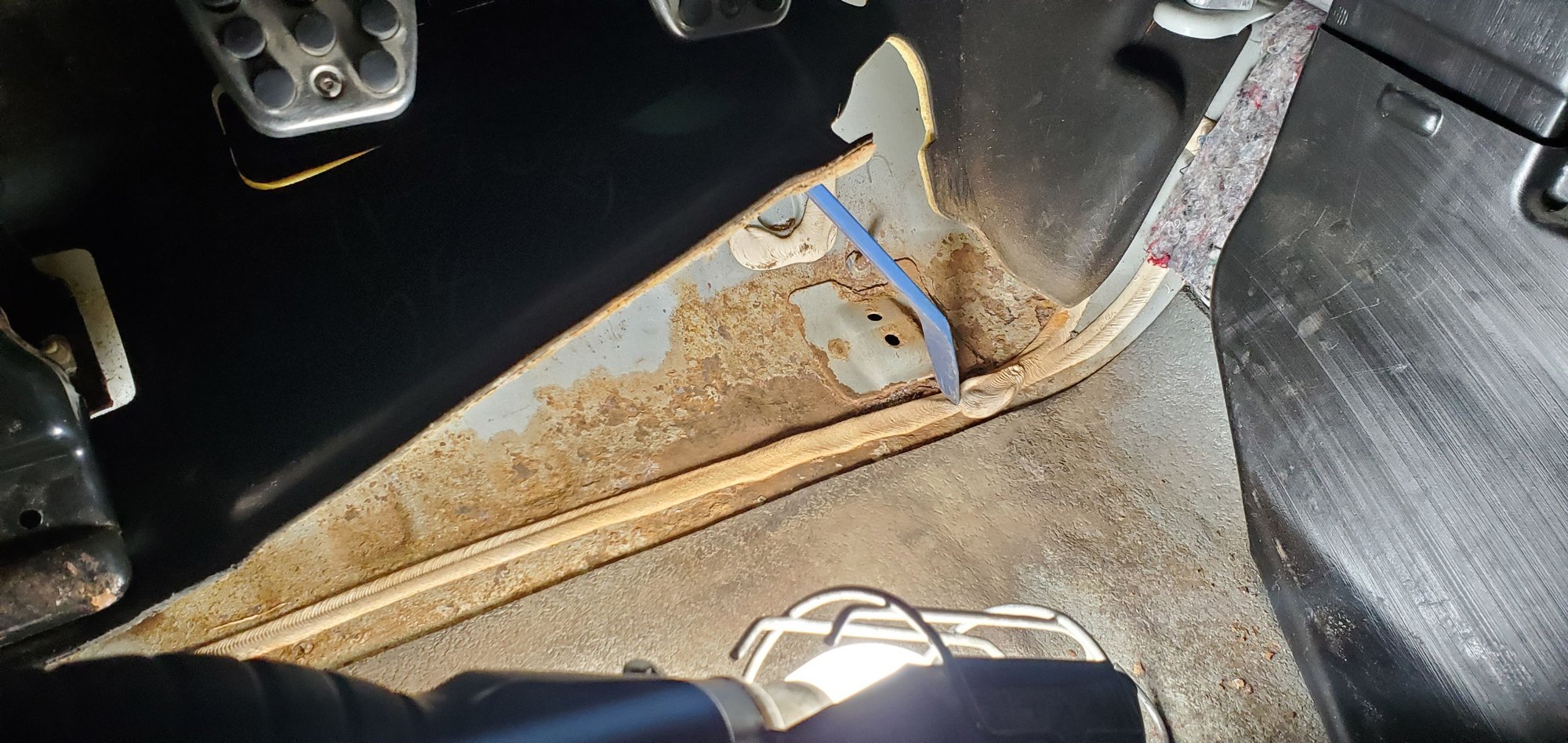

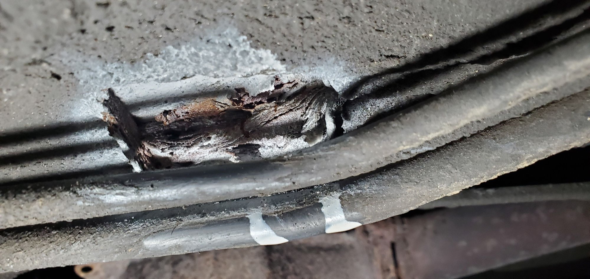

Found some new rust I hadn't noticed b4. Sorry for the photo bomb. Will recoat the under carriage with rust reformer when It arrives multiple times after drying to build up a good even coat on affected areas. bit of rust on rear fenders but not coming out to the body yet and they have been coated As well.
finding all this I'm not sure if she is worth putting anymore money into? I really want too but my bank account already isn't happy with me haha
Passenger rear. Coated with rust check (rust kill) hence the grey coating
Driverside floor panel approx under gas pedal. Jus noticed this yesterday. Coated again after this. Waiting on rustoleum rust reformer. Still solid couldnt push a hole thru it.

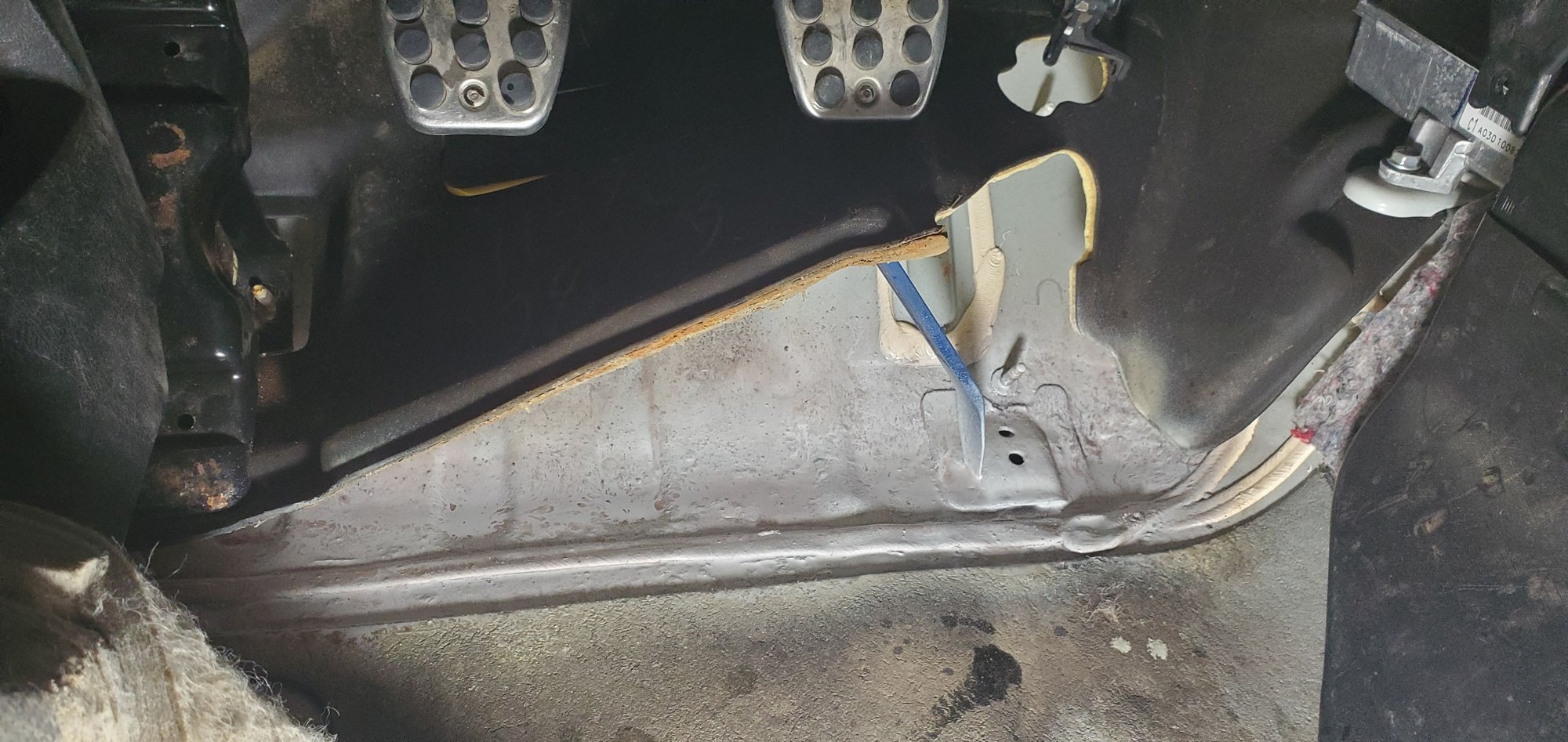

Investigated further, pulled driver side floor carpet and gas pedal to find this...
After a few coats of rust check (red) and then rust kill (grey) those 2 were the only rust products i had on hand atm. While drying i pulled passenger side and it looks good.
Wire brushed what i could get at and took the shop vac to it

$2k? pretty ridiculous...
makes me think should open shop just specializing in honda/acura clutch and timing belt jobs. Done 2g cl, 3 tl, & 8ga all with no sub-frame removal.
Also from the looks of your floor area photos, presuming there a windshield leak?

Havnt seen any leaks or puddles yet but judging by where it was I guessed water was dripping off boots and shoes in that area. Even the weather tec mats don't really cover all the gas pedal. Can drip right down and along that seem.
sorry for the confusion, 2k approx would cover parts and labour at a Mr transmission( 9 hrs was 950 labour approx )Their labour was 400 cheaper than a Honda dealer. Parts would include flywheel, clutch kit, oem pilot bearing, oem release bearing, rear main seal and o ring + fluids and taxes. That's if it's not too rusted to save..
