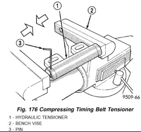

I do still have the pin thankfully, how do I get he pin back in the tensioner, is that something I will be able to push in by hand?
Old Aug 8, 2023 | 12:22 PM
Posts: 6,904
Likes: 2,210
Here is one way to do it:
