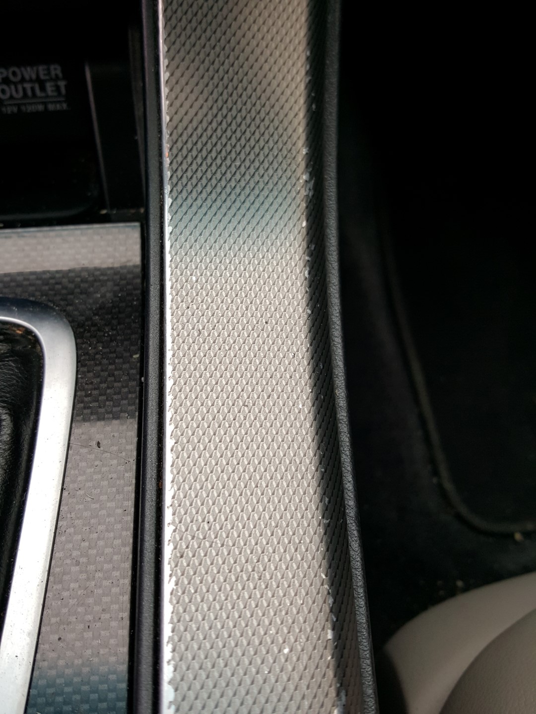

Oh, and I did something similar on mine... the drivers side paint was all scratched up like the OPs, but instead of sanding, I simply used 91% rubbing alcohol and the paint came off (with a little bit of rubbing). This left the original pattern intact, but shiny instead of painted. One thing to note is that the shiny metal does cause a little bit of a glare when the sun is hitting it. Not terribly annoying, but noticeable.
Attached is a pic comparing the drivers side (paint removed) to the passenger side (still painted).
Eventually, I'll do the rest of them so they all match (and maybe try something a bit stronger like goo gone or goof off)... though of course with any of this, you need to be careful not to touch other parts of the console/dash or you might mess up the finish.
Pat

Sorry to bump an old thread, but I did the same thing as DogP using 91% rubbing alcohol and MagiErase. Stuff came right off. It looks good, but is susceptible to scratching. Just gotta be careful with the keys.
