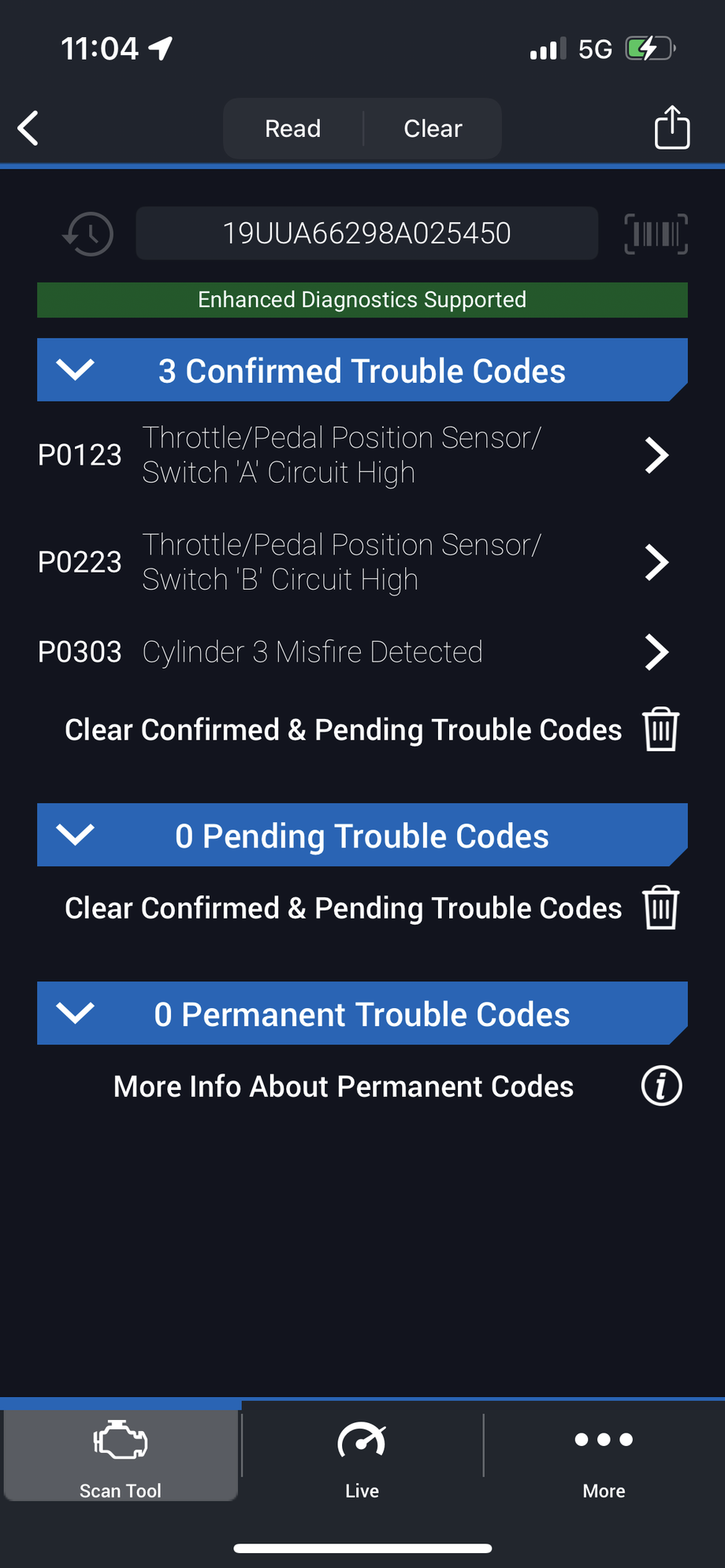

I’ve heard of people having erratic idle with the j37 tb, but I can’t explain the misfire. Maybe I didn’t reinstall the fuel injectors correctly?
installed p2r runners, j37 im & tb, thermal gaskets, aem v2 cai.
now I have this:
Thoughts?

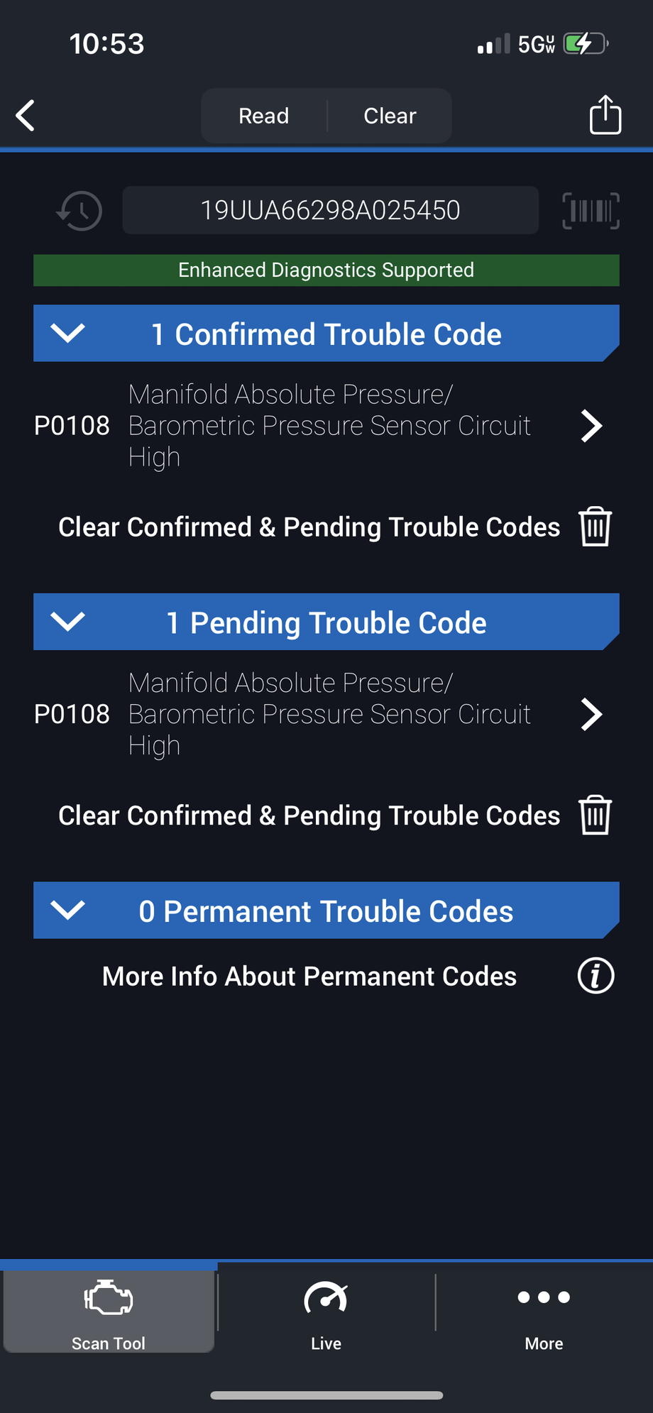

Went back to stock IM & TB and codes went away but now I have P0108
Old Nov 4, 2024 | 08:02 AM
marklittlefield4's Avatar
Joined: Oct 2024
Posts: 54
Likes: 14
From: Latrobe, PA
CEL turned off after driving about 50 miles or so. The P0108 was still in there when I hooked up my scan tool, but the dash light was not illuminated.
