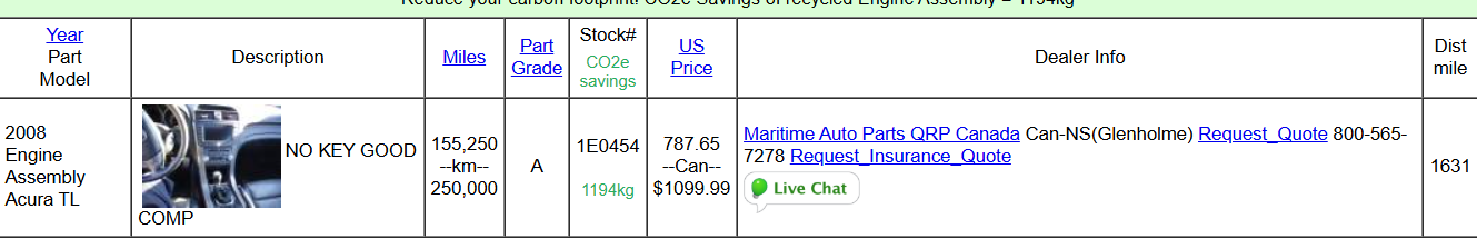

Here is a Type-S engine in Nova Scotia on car-part.com.
think I’m gonna look for somethin with less than 250k on it though
