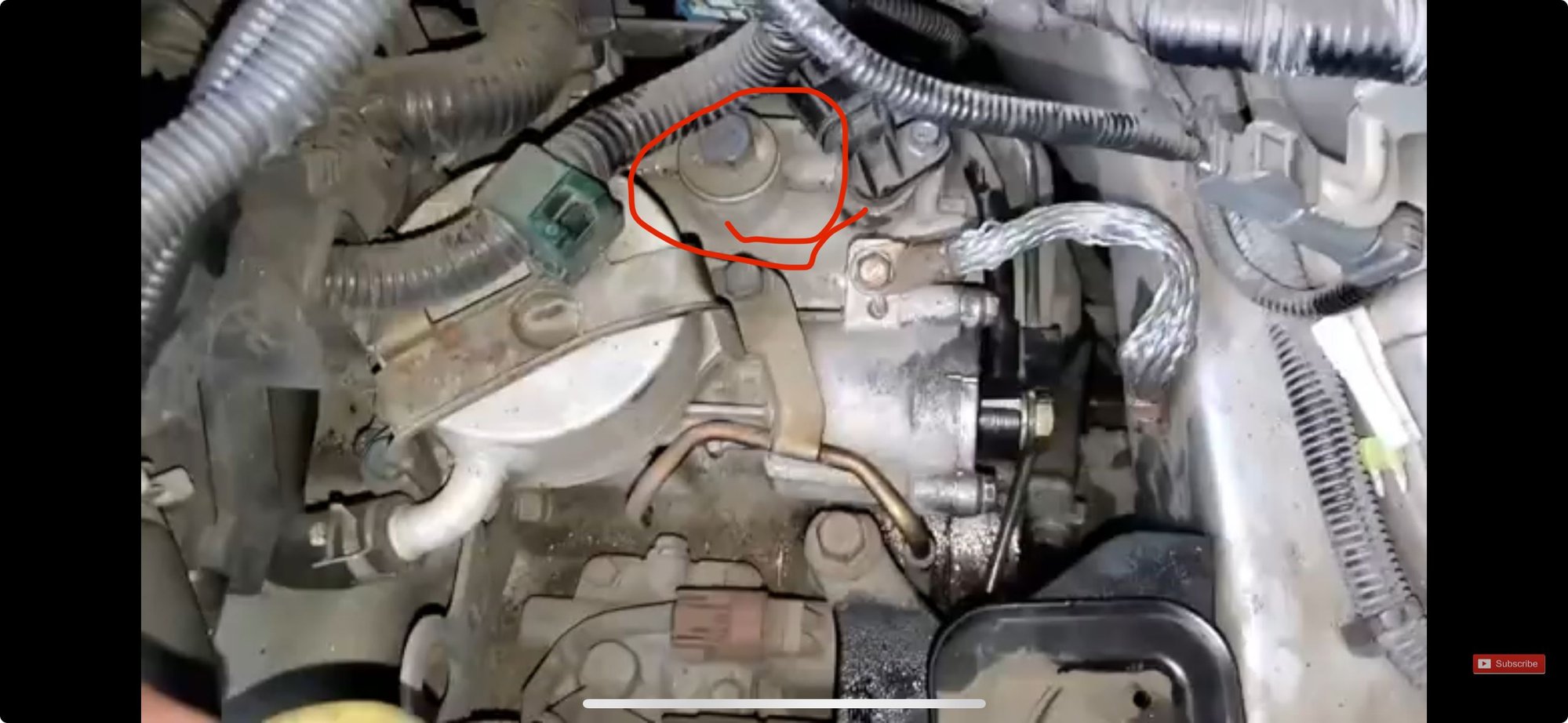

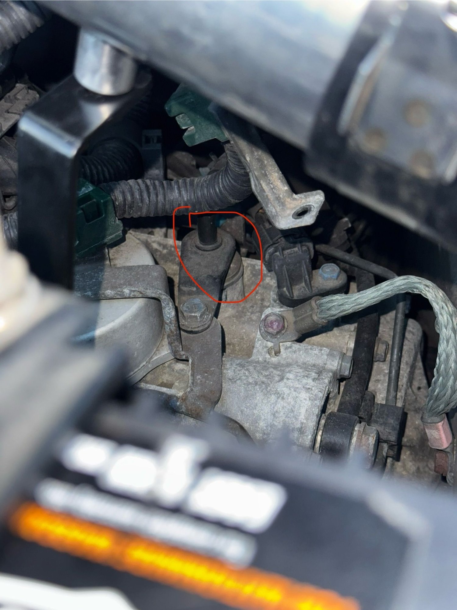

I have a 2004 Acura TL, J32A3 engine. i am trying to locate where to put new transmission fluid after I have drained it. I looked at a lot of youtube videos and they show a clear bolt beneath the fuse box. however, mine looks a little different (see the pictures). just line up the parts and you'll see what i'm talking about. let me know what I should do.

From the yt vid
vs. how mine looks
Looks like you have one of the early 3G TL's that needed to have the trans fluid jet installed to ensure the trans works properly for the 2nd gear.
You can remove that and then pour in the fluid. If you ask your dealer they should be able to give you the TSB on how to refill it:Alternative which will take much longer is to use a small tube (Homedepot/lowes) and connect that to a funnel and slowly refill from the dipstick tube for the trans.
