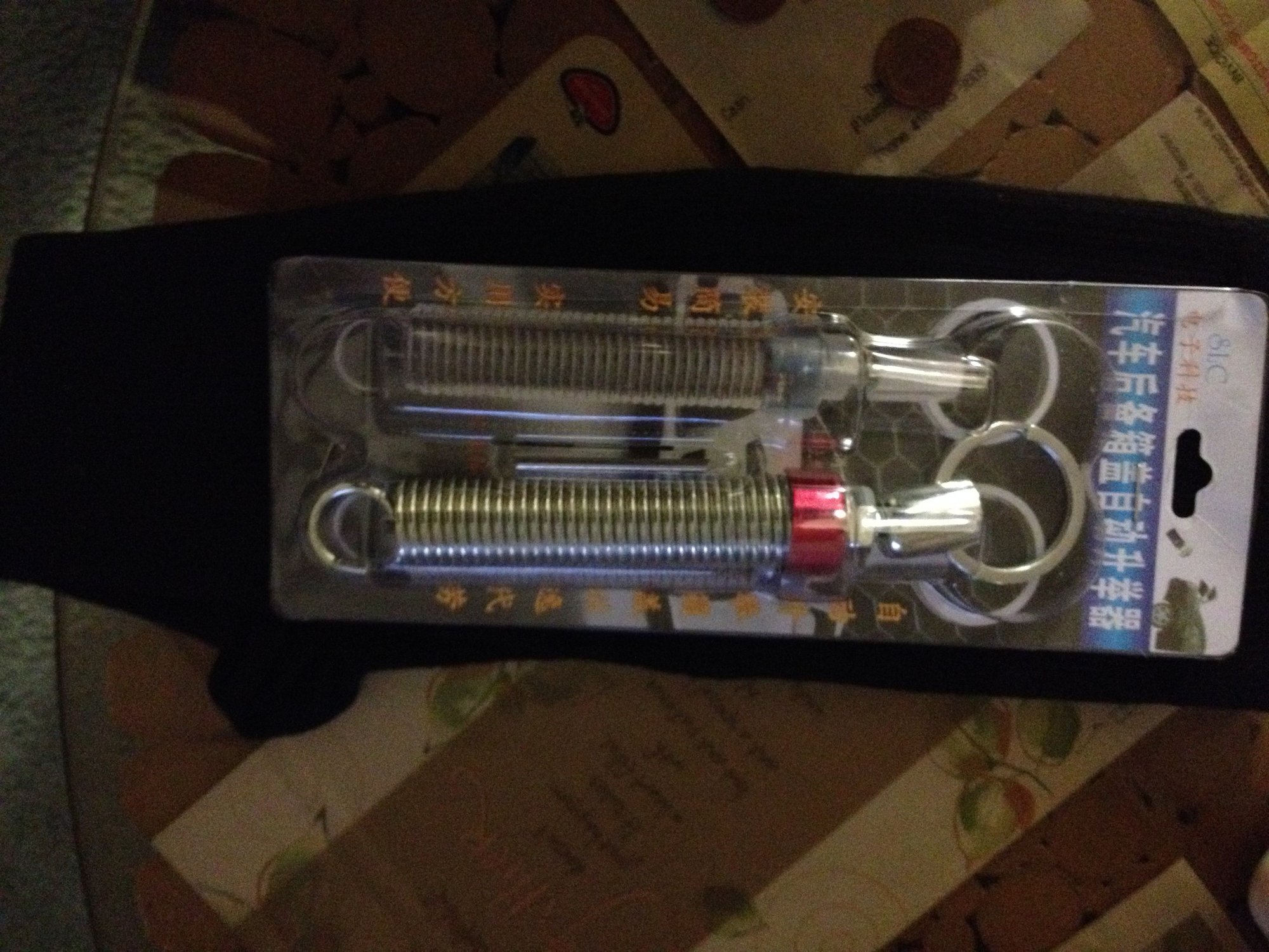

03 TLS Walmart trunk assist spring
i bought this "trunk lift support spring" from Walmart. It came in a package of two. I only used "one" on the passenger side, as it provided sufficient action to lift the trunk lid about 14 inches when hitting the trunk release button. I'm certain that adding the other spring to the driver side would lift the trunk lid completely. Prior to installing this spring, the trunk lid would only unlock the trunk lid, and provide zero lift. The springs were cheap, $9.00 and required no tools to install. Installation accomplished in less than two minutes.
