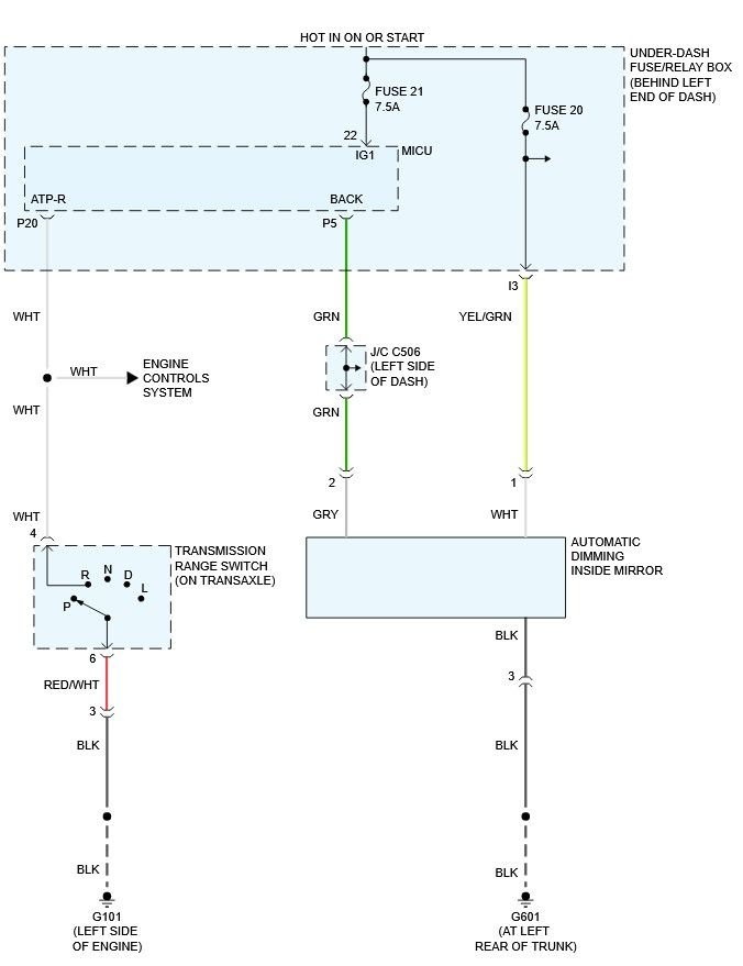

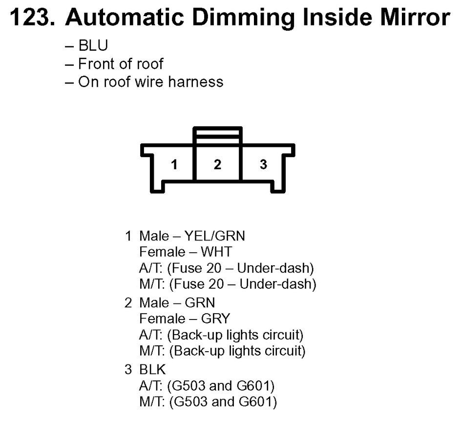

Hello ya all. I'm installing a automatic dimming rear view mirror, the car was ordered,?, Without one. Can anybody tell me on black( ground),:the other two wires look like brown maybe gray, where should the splice be. I got a used oem mirror that has the 3 wire harness. I appreciate ya all

Are you installing it in 2005 TL? There should be a connector for it unless somebody cut it off.
Anyways, one is key-on power, other gets power when you throw car in reverse (most likely to disable the dimming feature to make backing up easier) (you can leave this one).

I got it but i really appreciatye you're time, thankyou
Old Jan 17, 2022 | 08:45 PM
Jeffery Zweigle's Avatar
Joined: Jan 2020
Posts: 22
From: Windsor Colorado
I appreciate you're help, yep it was easy
