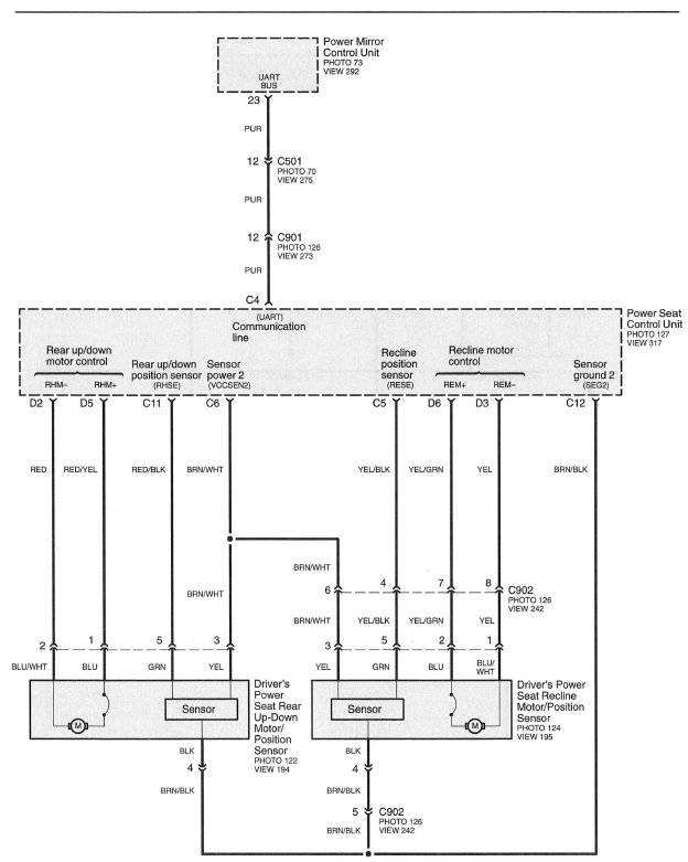

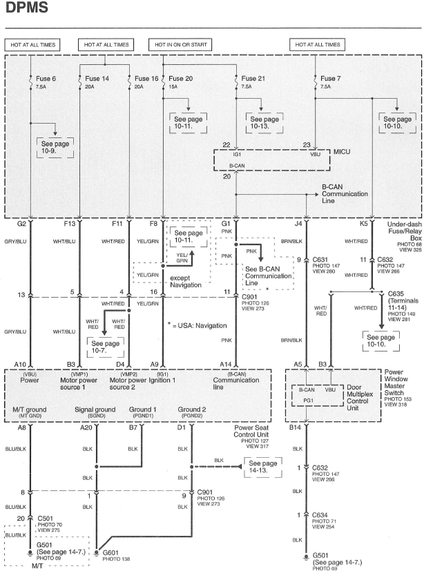

Anyone have the wire diagram for a 2007 TL Type S driver's seat? My recline and slide quit working awhile ago, then started working again long enough for me to slide the seat all the way back and died. Attempting to trouble shoot where the problem is with the seat out of the car. Any info is appreciated!

Driver seat wiring diagram:
