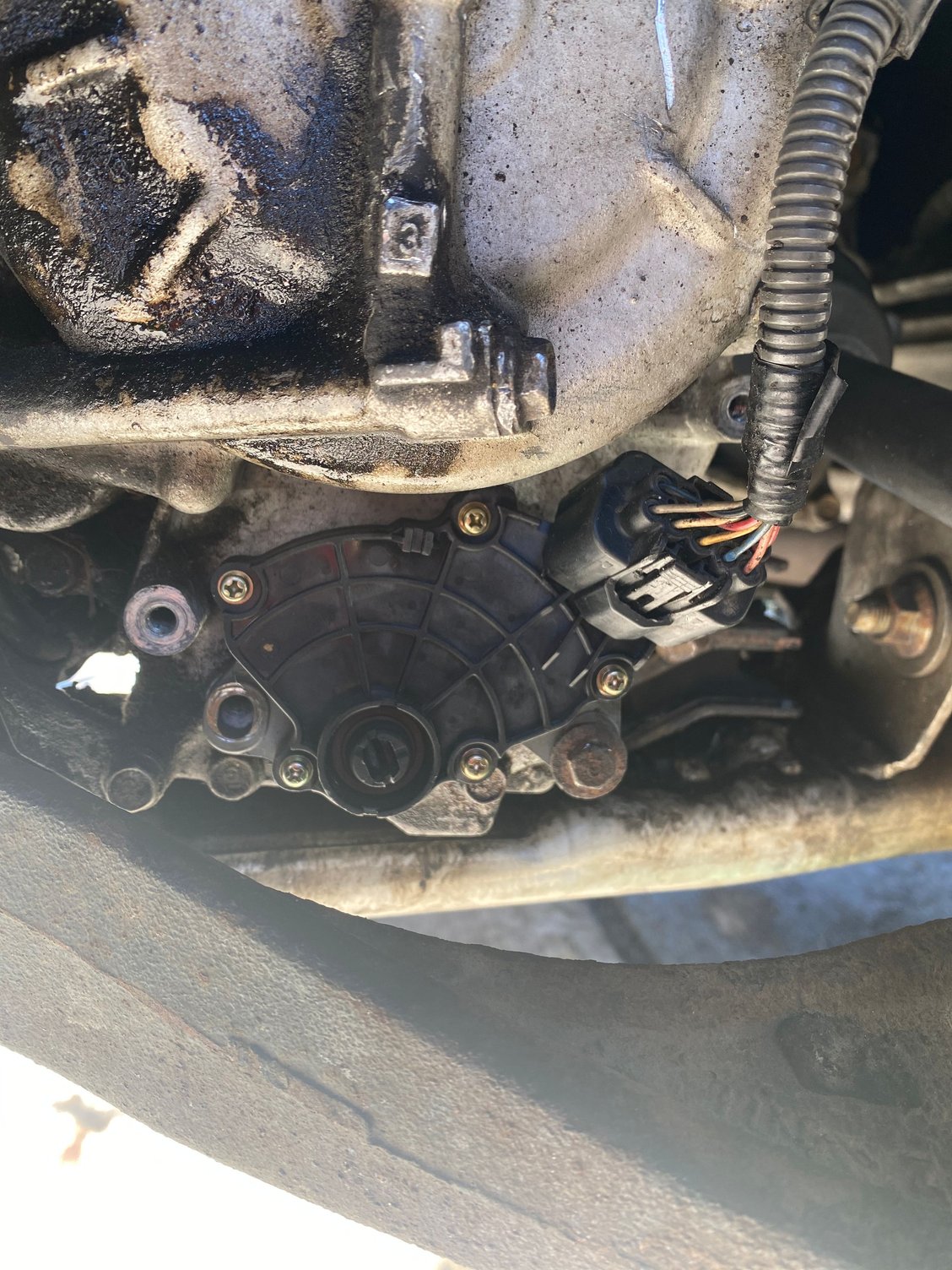

So, I want to thank you for that brake switch situation. The shifter is now shifting the only thing is that when it shift it doesn’t shift correctly. Attached is the video so you can see what I’m talking about

thanks I’ve done this adjustment but for some reason I have way too much slack left on the cable. I went underneath where the shift linkage attaches to the transmission and I’m trying to see if there is a way to adjust it there and not up by the shifter. I did read there is a way to thread a nut but I can’t seem to find it.

Originally Posted by Jayproductivo
So, I want to thank you for that brake switch situation. The shifter is now shifting the only thing is that when it shift it doesn’t shift correctly. Attached is the video so you can see what I’m talking about https://youtu.be/soGc0G7hmDM
You're almost there! My guess is the TRS needs adjustment. I haven't done it myself so I can only say check the shop manual for that exact year, they're free to download somewhere on the forum. Too much slack makes sense, as your trans is a few gears behind your shift selector.
Is it possible you're missing parts from that TRS? From photos it looks like there is a spindle that sits on top, and maybe a cover too?

When I initial began with the problem I took everything apart to try and find the problem. There isn’t anything missing that I know of. I’ve swapped these trans a million times on Honda’s and even tho these trans are identical I have checked a million times to make sure nothing is missing. I think that due to the slack it’s what’s causing that although, yesterday I went under the car to put the car in park and noticed that the bushings on the cables were slipping off. Can this be the cause to the slack?

So, it seems like all odds are against me at this point lmao. I finally got the adjustment to the cable done by pulling it off completely and turning a nut by the hole in the floor. I noticed that all lights on the dash were lighting up but the L, so I unplugged the Neutral Safety Switch pulled it off to make sure it wasn’t broken and put it back on. After putting it back on and connecting the connector one of the relays began buzzing so I went bought another to replace and even though it may not buzz the car is not cranking 💀💀💀 KILL ME NOW lmao. The car was turning on no problem before doing so and the lights were all lighting up with no issues now they are all off. Watch video to show what I’m talking about now

So, I want to thank all of you who gave inputs on this problem I was able to diagnose it all at the same time using ALLDATA, here is the outcome.
after I Initially put in the transmission and I noticed that the car will not crank at all. Everything pointed back to what I thought was the starter or bad battery. I soon came to realize that after getting new battery and starter the car would still not crack and AllData then pointed me to the Transmission Range switch. And with the advice of someone on here STOKE I believe I came to find out that the car was in shift which is why it would turn on. I pulled the Shift Linkage Cable forward and once it landed it Park the car cranked. The car wouldn’t shift after the fact and I switched out the brake pedal switch which allowed the shifter to change gears but the gears on dash would not match to what gears the shifter was shifting to. So I took the shift cable out and adjusted it with a nut and put it back in and the shifter aligned. After doing that I got a buzzing sound from one of the Relays and I went and changed out relay but then returned the relay after diagnosing that it was a faulty ground wire on the power steering pump. Replaced that and the car is good to go. Thank you all for everything
