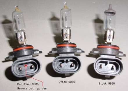

Old Mar 16, 2015 | 10:41 AM
Posts: 48,314
The difference between the bulbs are the two guides in which the male plug mates with the female. Also the socket is just a tad different as well:
If you grind down the bulb both the guides the the part that rotates into the socket, you can get away with using the existing DRL bulb in the new housing.
OR you can make a quick harness (9006 female to 9006 male) and use a proper 9005 bulb in the Type S housing.
