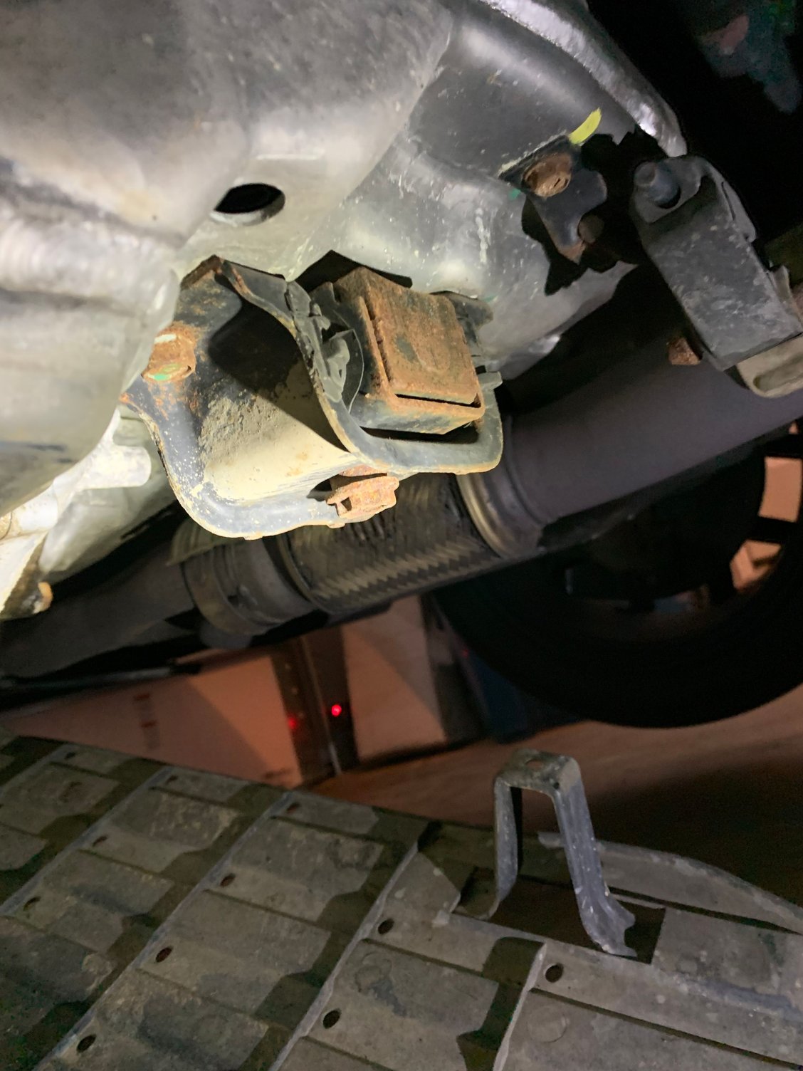

Hey Guys can anyone tell me what this part is?
It’s pretty loose and is the source of a clunking sound that’s been driving me crazy for the past few month. Finally decided to get underneath and look around a bit and voila. Thanks.

It's #21; Shock Absorber - Acura (50420-SEP-A01) DAMPER, FR. SUB-FRAME DYNAMIC (RR) on the OEM vendor link below:
Front Beam - Rear Beam for 2008 Acura TL | Delray Acura Parts (acuraoemparts.com)
More discussion here:What is this? - AcuraZine - Acura Enthusiast Community

thanks for the quick knowledge!!
