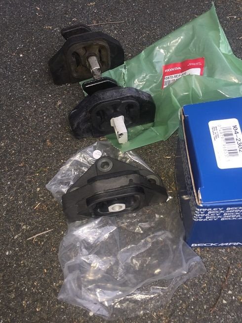

Ordered a new BECK/ARNLEY 1042302 upper tranny mount from rockauto and the plan was to fill the gaps with 3M Urethane. OEM mount listed is
50870-sep-a92. Got the mount in, filled the voids with urethane, let it cure and was browsing the service manual on the replacement steps only to notice that the mount visual in the repair manual and that on Acura online parts catalog is different than what I was sent. Rockauto claims it is the correct mount though.
Anyone changed the upper tranny mount on their 07-08 TL-S Auto.
It seems the stock mount looks like this
However what i was sent is missing the arm in the middle of the rubber insert.

The OEM mount I used to replace my upper transmission mount looks exactly like the second picture you posted.
I do have an '06, which may have a slightly different mount than the '07, I'm not sure. There is a bolt that goes through the top of the mount and into the metal bracket that attaches to the transmission. There are three bolts on the side of the mount that go into the frame of the car.

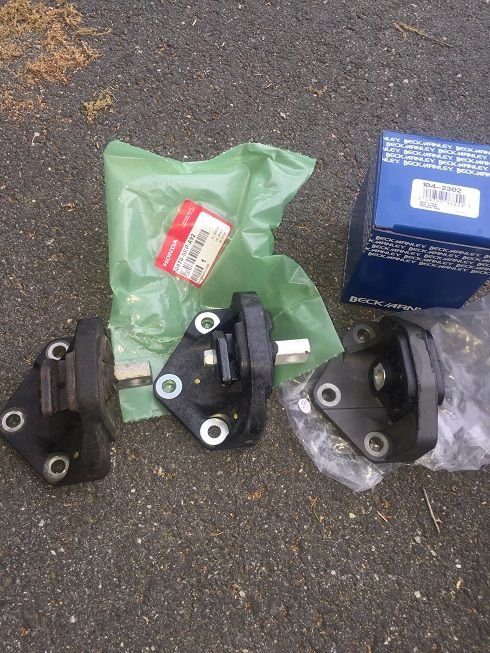

that's the wrong mount. 04-06 TL is different than 07-08 TL. I just bought the same thing from them like 2 weeks ago to do upper trans mount and it was wrong one. I ended up buying OEM Upper Trans mount to save myself from headache. See pic.

That's weird that they said that. What they said to me was, send an email to them at service@rockauto.com with the mount you bought, the mount in the car, and the VIN# (that's why I took that pic side by side, pic was for them), and they will contact the manufacturer and issue you free return shipping and refund. See email message below.
"I sent your photos - and VIN - to two manufacturers (Beck/Arnely and DEA) for review. Both recommended returning the part for a refund considering it wasn't a match to your particular vehicle. I was hoping they could help identify the correct part but neither could recommend a part number that would be correct. So, why your vehicle requires something different is not clear and unfortunately, it appears we may not have what your vehicle needs.
Considering the part should have fit - according to multiple manufacturers - but did not fit your specific vehicle, we'll refund the part cost and cover shipping one direction.
I have sent return instructions to your email address. You will find a prepaid shipping label at the bottom of the return instructions. You will receive your part cost refund within 3 business days after tracking information shows our warehouse has received your return. We will email you when the refund is issued.
Hopefully you can locate the part your TL needs."
I hope that helps you with the return/refund.

Great pictures for evidence from Hazsun.
Makes sense the mounts are different between the 04-06's and 07-08's because they have different transmissions, thanks for the clarification Hazsun.
