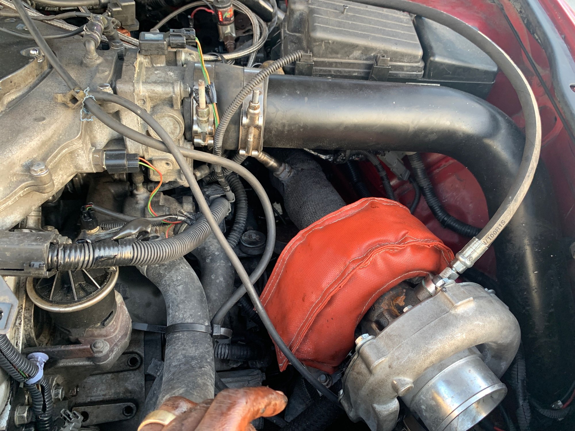

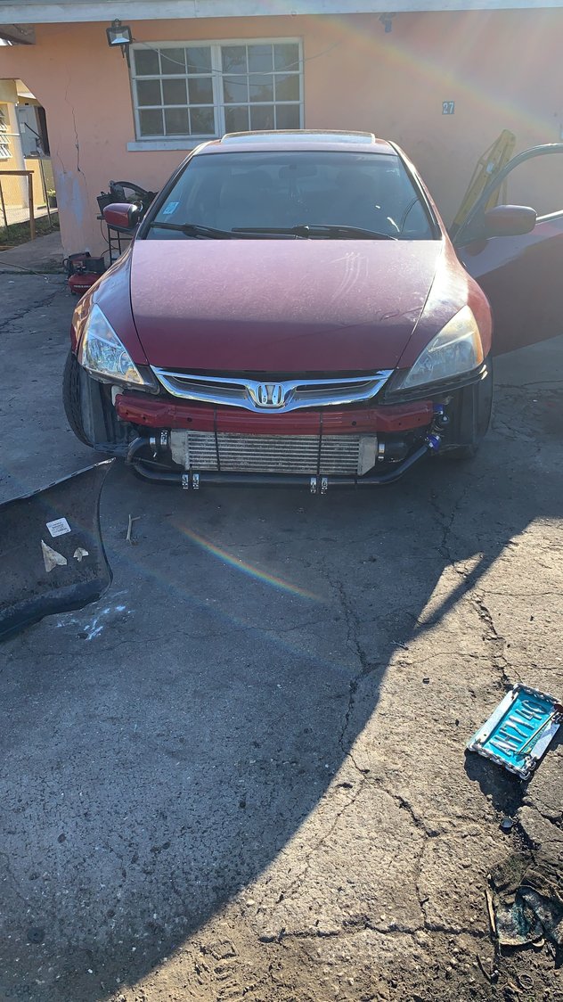

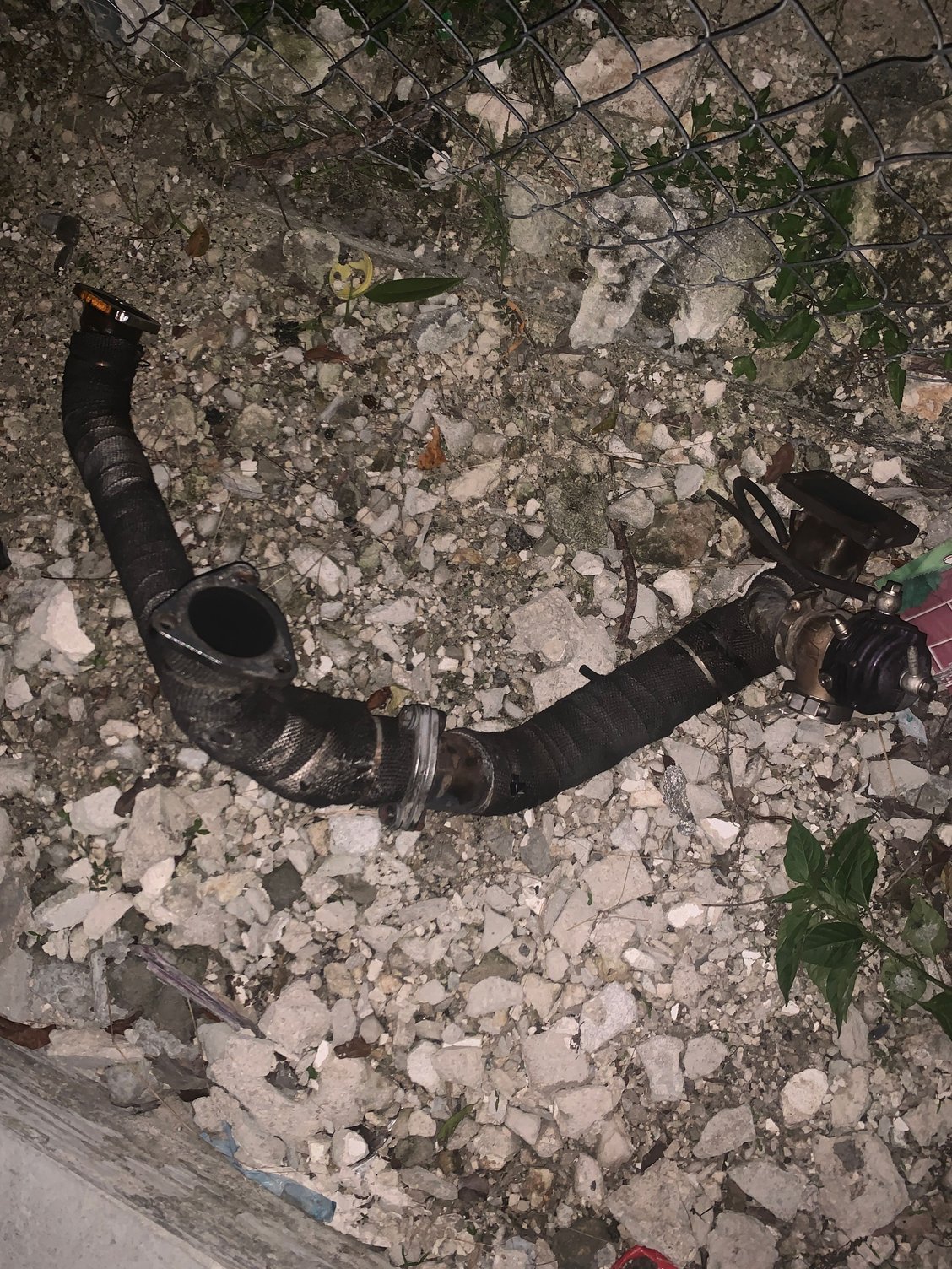

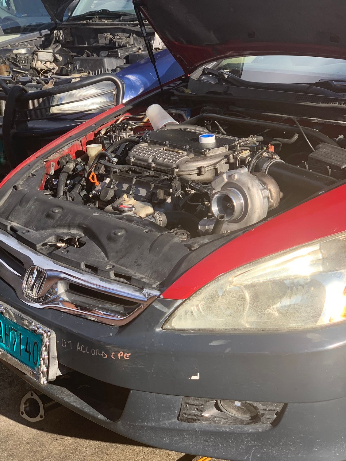

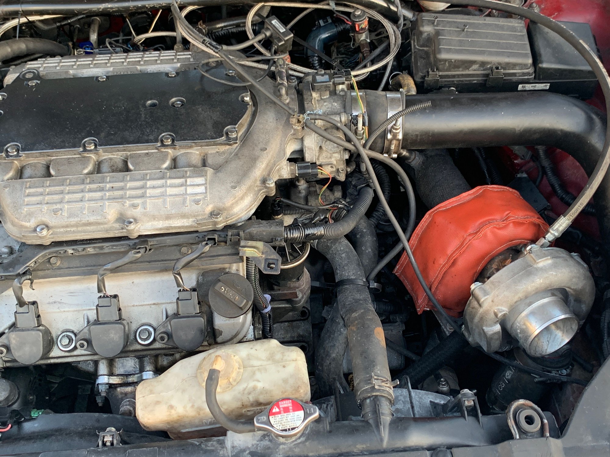

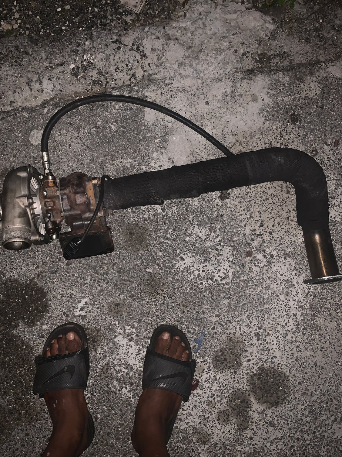

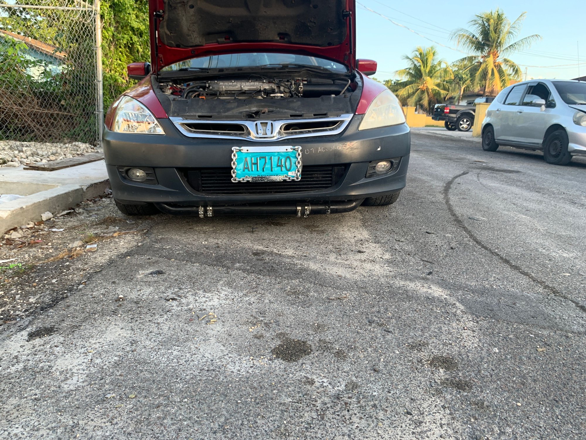

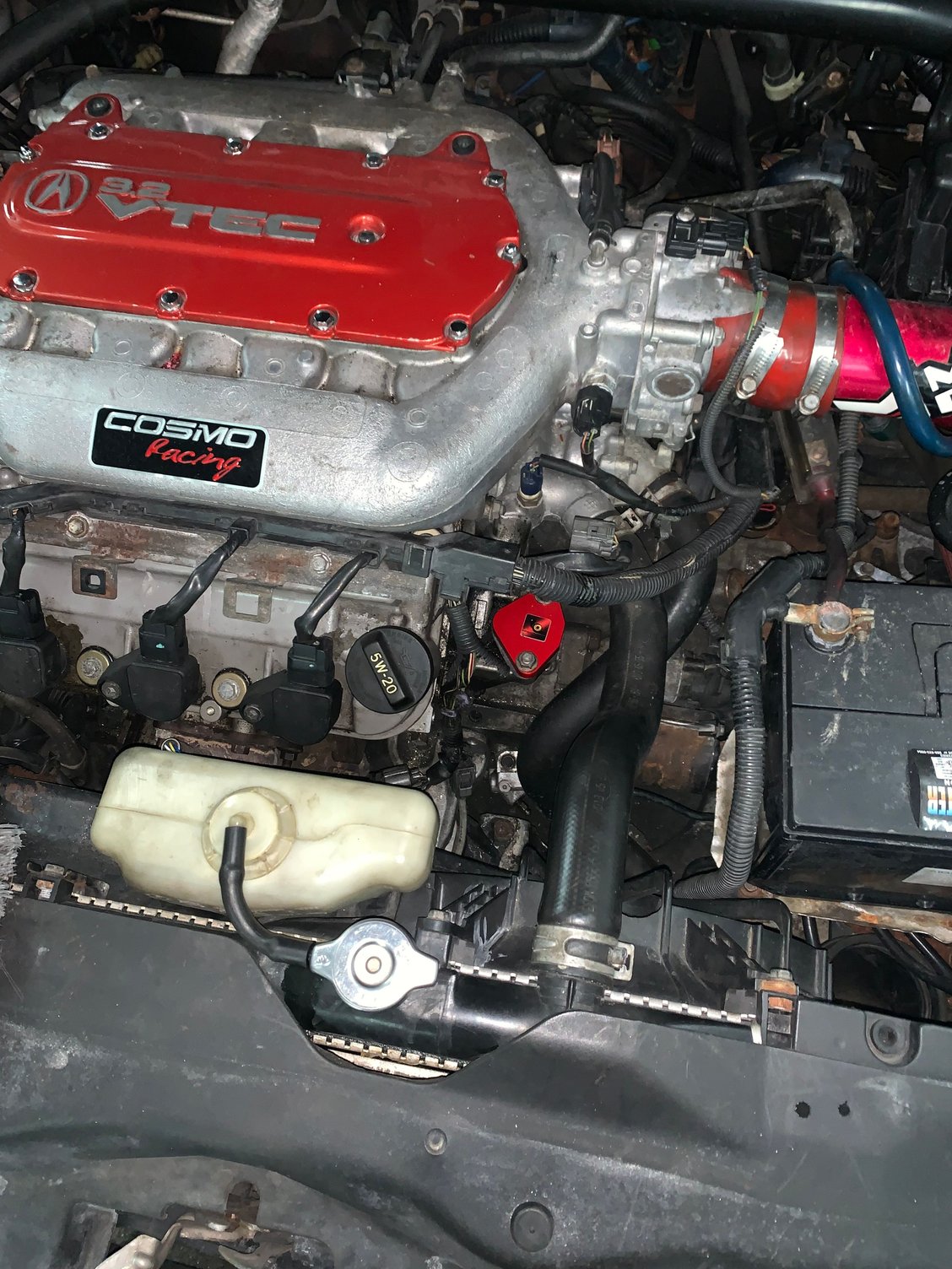

That is exactly what I brought for my 04 accord hfp with a j32 swap. I also brought the cat delete manifolds and welded both to make it work actually I replaced front and rename subframes from a 04tl sport

Good stuff Patreo Sherman, thanks for your contribution and pictures.

I used the same kit as that guy. Kit was for a 98-02 v6 accord. Then I brought the cat deletes and welded those puppies to make what was needed

My turbo spoils at 43-4400 rpm, I am running 6psi, on stock internals. I also have a spare engine that I want to rebuild. I am waiting on some stock j35z3 pistons that I ordered for the 08-012 accord 6speed. A very good source said it should drop my compression to about 9:8:1 soooooo more boost I say

I went to the dyno and did 250 on my first pull, but the rain came down so we had to cAncel the tuning session. But since then I removed the engine and was about to install some j35 pistons from the manual 2012 accord that should drop my compression to about 9:8:1. Just waiting for my bearing so the I can reassemble the block. [
