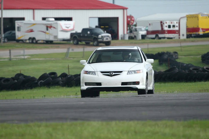

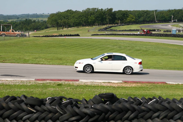

Here are some pics from yesterday and just some sample car shots. Will edit and get vids up too.
Here's just a pic of the car as is

Here are some shots I tried to get to show the car at the end of the day.
