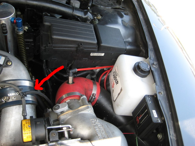

like i said i'm not spraying at the moment. i'm not sure abt the nozzle location - according to Snow it is safe to spray before the throttle body directly into the blower which will keep it cool/lubricated. I think i'm going to move the nozzle behind the blower though. I'm using the smallest nozzle it came with and the variable controller gives u control over what boost levels to spray. Marcus (heeltoe) did the install really clean...you can see the motor sitting behind my filter bolted to the frame..

Clean install! Do you ntice a difference not that you are not using it? Also do you order your meth through snow as well?

againstallodds has a clean install as well.
http://img220.imageshack.us/my.php?i...sc005162eg.jpg
when you move it couldn't you fit the nozzle in the blue silcon hose.
WHOA, you have the meth plumbed BEFORE the SC?!? not sure if thats a good idea =/

Absolutely spray after the blower. You want it 6" to 1' from the TB. You will never see the full benefits of the meth with it injected pre-blower.
You guys should go over to turbobuick.com in the alcohol/nitrous/propane section. Research has been going on for years and years and many have tried it pre turbo, post turbo, dual nozzles with both pre and post turbo at the same time, water, rubbing alky, methanol, propane, even hydrogen peroxide (you would be very surprised at the power), etc.
In my own research with a big shot of meth at 26psi, 80 degree day, 120-150 degree post intercooler temps, meth dropped my charge temps to below 60 degrees.
Would there be any issues installing it were the navy blue silicon hose in his picture above?
That looks like a good place for it. The nozzle is usually set up to spray opposite the incoming air, sort of like pissing into the wind. I ran mine like that for a long time with no problems. Even though it didn't hurt anything it was always in the back of my mind that silicone was holding the jet in. I eventually had a bung welded on to the metal pipe for a more solid installation but in my application 20psi is considered low boost.
wait.. which blue silicon????
After the blower, 6" to 1' before the throttlebody.
the TB is before the blower...the IAT sensor is on the intake manifold after the blower

I have heard that before the blower would hurt the blades of the charger.
You're right. I have turbos stuck on the mind...
6" to a foot before the intake manifold. Depending on the kit you use you may have to use some sort of a vacuum break. With the cheaper kits the vacuum in the intake will try and siphon the meth out. My turbo car originally had the TB before the turbo so I had this problem with an older kit.

I run the snow performance on my Mustang now and I ran it on the TL also. The best way to run the methanol is
1: Running the extra methanol increases octane wich will burn slower and allows to run more timing. More spark advance, more air and more fuel is more power. Every 1 octane allows you to bump timing up .5*
2: Running methanol without a tune will cause the A/F to be too fat. With a tune you can pull fuel to a decent A/F ratio. When your air to fuel ration is rich your car will make less power.
Now the downfall is that with running the kit and if the pump fails or the reservoir goes empty you are running too much timing that can cause it to detonate. Too much timing and detonation =
So the best thing to do without being able to tune the car is to just run it to cool the IATs down. Most cars computers now are programmed to pull timing when the IAT's get to a certain degree. So running the water meth will cool the intake temps down and prevent timing being pulled.
Its a better idea to run it after the blower cause it will cool the compressed air. Compressed air is HOT air. Then you will need a solenoid to prevent syphoning.
Its not bad to run it before the blower cause it can cool the rotors off in the blower and cool the air down.
