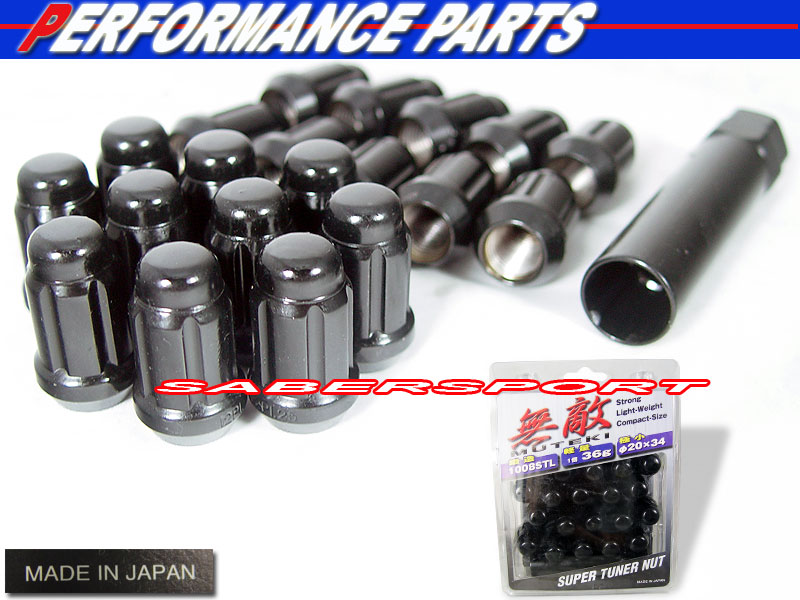

Another cool weight saver- featherweight lugs (for aftermarket wheels only)
I have both Muteki and Kyokugen open ended lugs, black and silver respectively. Both are excellent and recommended. They are extremely light and strong in comparison to regular lugs, especially the stock ones. There is a whole bunch of different brands and colors for any taste and pocket out there...
http://www.evasivemotorsports.com/me...tegory_Code=L1
Note, those living in harsher climates, like me (New York), should not get the open ended lugs or else your lug studs will begin to rust badly. You can imagine what's going to happen in the winter, with all the snow and then salt we get
Plus it's very humid in my area in the summer, a lot of moisture in the air=a lot of rust!
That's why I gotta buy the close ended ones now, oh well...
![](http://www.sabersport.com/Merchant2/images/nuts/MT-41885B.jpg)
![ugh](https://acurazine.com/forums/images/smilies/ugh.gif)
![Tomato](https://acurazine.com/forums/images/smilies/tomato.gif)
