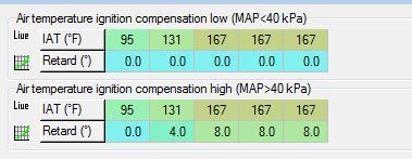

For those of you who tune your own cars or have knowledge of the program, I have a question. With regards to the IAT and timing, how is the table set up? How much timing does the pcm add/subtract based on IAT. Thanks in advance for any info.

From the stock 04 map:

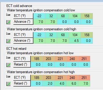

Very good info Sir, thank you. Does it have an add table for temps less than 95?

Not that I could find. There is a cold advance based on coolant temp though:

Exactly what I needed, thanks for the reply.
