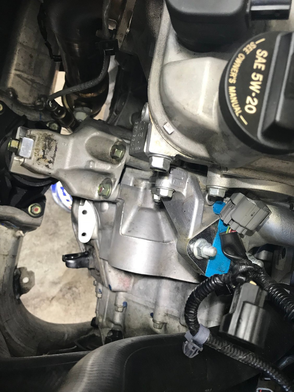

Fellas, I’m not able to get the last 3/4” of the transmission onto the block. Could I have misaligned it?

Old May 25, 2019 | 09:29 PM
  #891
It could be that the male splines on the input shaft are not aligned with the receiving female splines at the end of the clutch disc? Or maybe it's hanging up in pilot bearing in the flywheel? Do the diameters look the same from the new FW to the OEM FW? the alignment tool should fit in both. Maybe try using your flywheel turner tool and slightly turn the FW and try again?
Looking at this picture, I'm thinking that its just a matter of getting the end of the input shaft into the pilot bearing. You can see a slight misalignment in the tranny case, in relation to the engine block. You may have to, somehow, grasp the rear of the tranny case, as you apply forward pressure, and slightly move it around to get that male end of the input shaft into the female pilot bearing? It's gonna be hard on your (lumbar) back if done from the top; however, not sure if you can do it on your back underneath.
