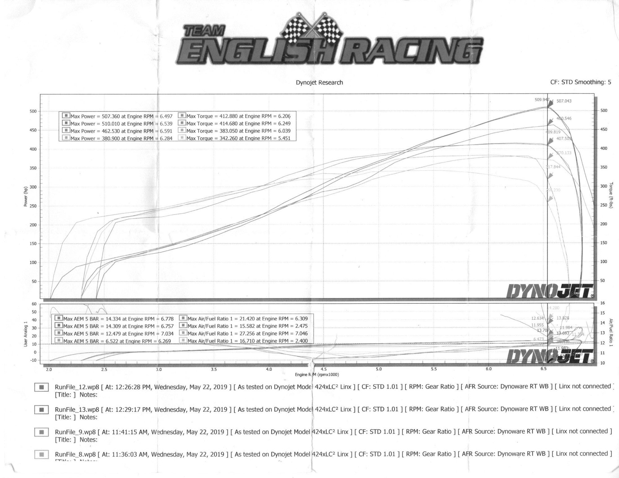

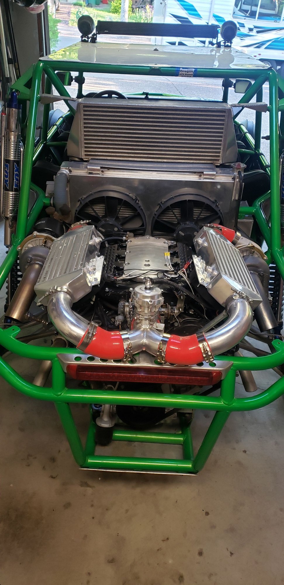

Old Jul 29, 2019 | 12:31 AM
3.7dude's Avatar
Joined: Mar 2017
Posts: 28
Sleeved block
JE Pistons
Pauter rods
ARP head studs
GTR injectors
Supertech springs/retainers J32 cotters
Precision turbos
Tial bov, and waste gates
AEM Series 2
Tuner thought 500whp was ridiculously conservative and had no problem hitting goal in a couple pulls. Needs custom injectors to get 600+hp, we are at 90% duty cycle now.
Old Jul 29, 2019 | 09:45 AM
90foxnotch's Avatar
Joined: Jun 2017
Posts: 977
Likes: 151
From: OHIO
Oh wow, that is beautiful. That has to be a blast to drive. Do you have a full pic of it?
