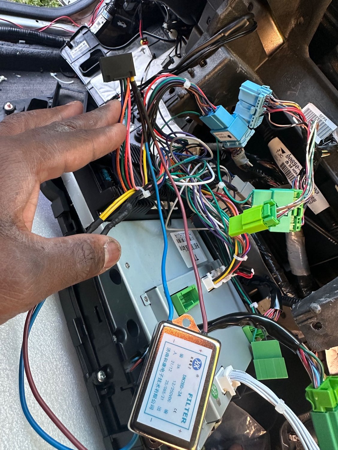

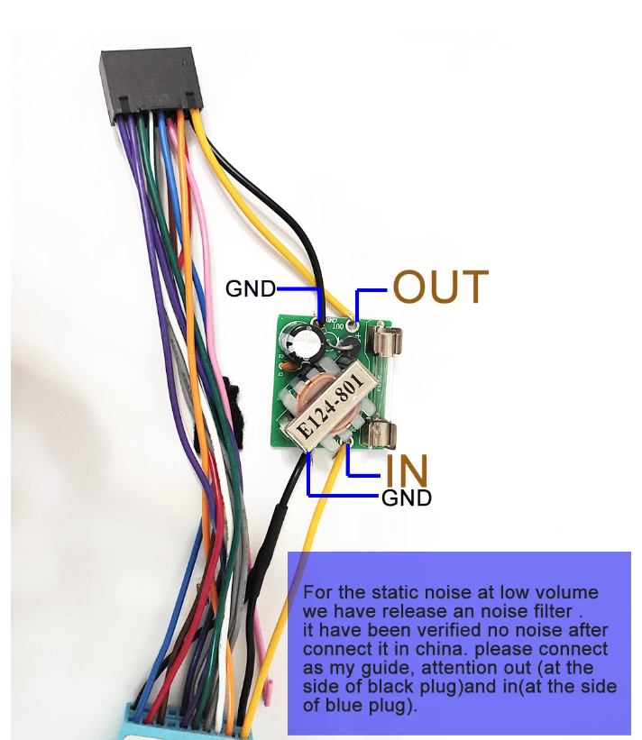

any one has links or wiring diagram to attach the noise filter. appreciate the help

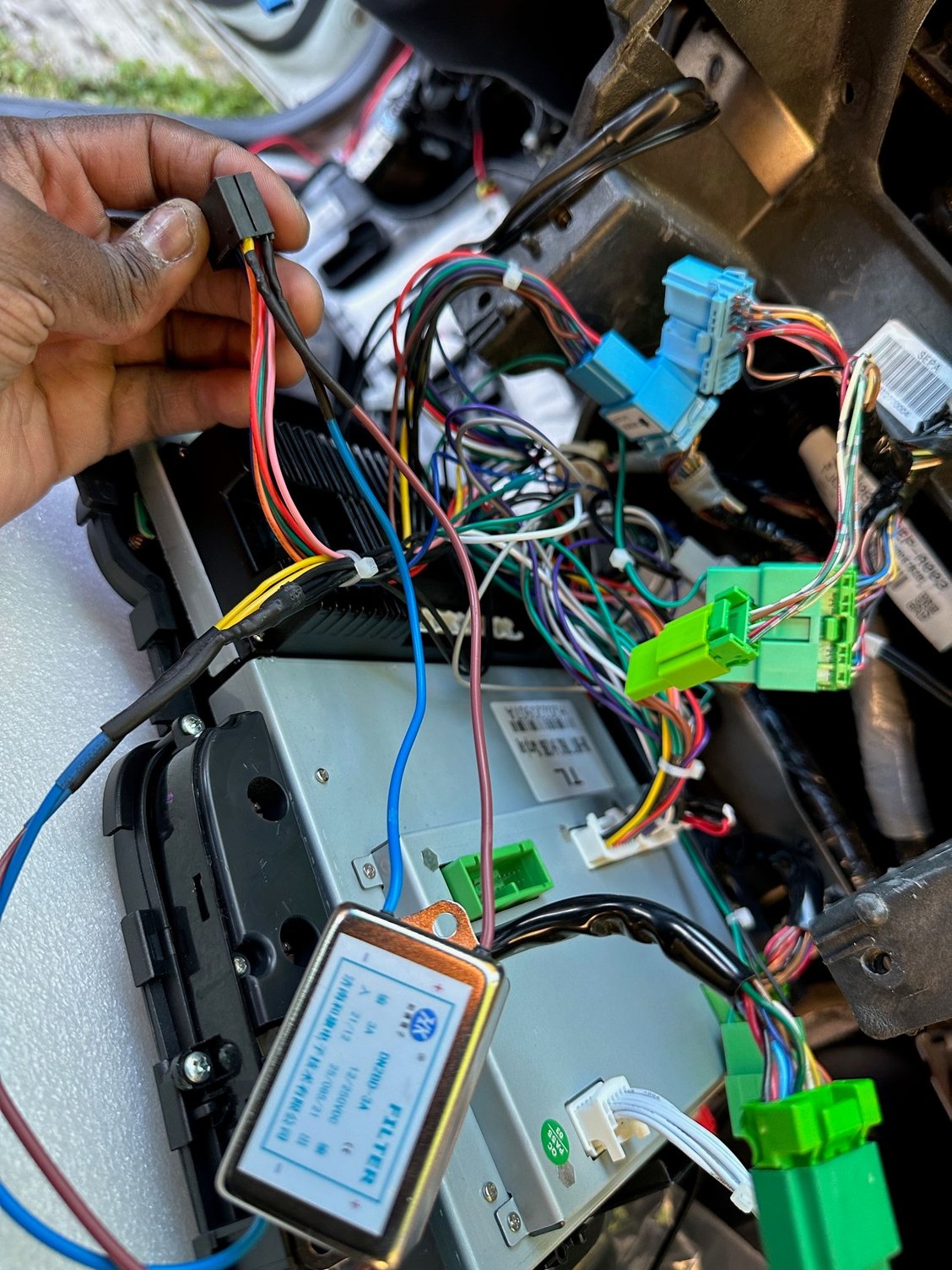

Below is a photo of how I wired mine up and a stock photo of their instructions. I did screenshot my setup and sent it to Navitech and they said it was done correctly. That being said, I didn't notice a difference before or after to I ended up not going with the noise filt.er
