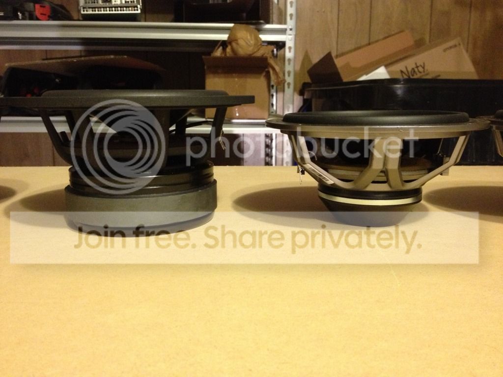

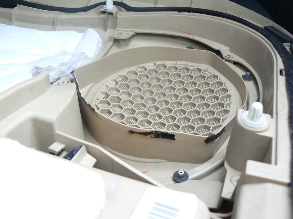

Here is the dilemma. In this picture you can see the vertical fin with black residue that I am contemplating trimming off. The residue is from a foam gasket material that I pulled off. This was OEM to seal the speaker to the door panel.
The next picture shows the ID's on rings sealed in with cascade. My primitive measurements indicate that the fin piece really has not enough room anymore.
Currently I have one door "completed" with the door panel in place with the fin and gasketing material intact and my other door sealed and deadened but no door panel in place. It is night and day difference in the sound. If its just the plastic speaker grille causing the attenuation I would be surprised. If thats the case I would rather cut that plastic grill out and use some speaker cloth in its place. It looks like the aluminum trim ring around the speaker hole could hold some fabric in place?
But if there is clearance inside then that fin is actually helping to focus the sound out of the speaker opening and cutting it would be counter productive. Arghh I just cannot see in there to tell. Only hear the difference.

Ok, so I just popped the corner up on the one installed door panel and there was no change in sound quality. Clearly the fin structure is not interfering. I believe the difference I was experiencing is that you naturally think the louder speaker sounds better and the one not playing thru the door panel was not being attenuated by the plastic grill cover. Everything is back buttoned up and sealed and sounds good.
I just wonder how much better it would sound with the plastic grille replaced with audio transparent cloth? I cannot figure out how to remove the fasteners holding the metal trim ring or I would try it.

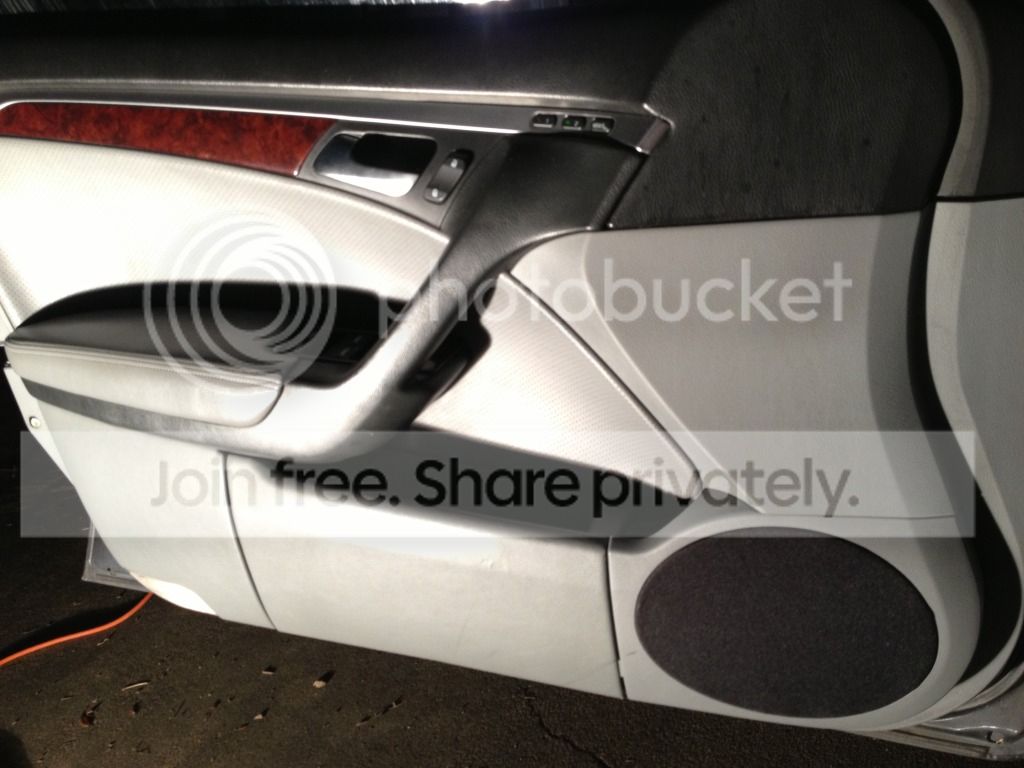

So I mocked it up. No cutting yet, I wanted to get your guys' opinions before I cut on a $1,000 door panel. Here it is, I stuck the material under the trim ring so just use your imagination. It will be riveted and glued on when I'm done. It actually looks pretty factory in the lower lighting when in the car. I just don't want this car to look all modded like some 16yr old kid would do. It has to look factory.
To clarify, the factory grill has to be cut out so this will be permanent. I forgot to take pictures with it in the car but unless you own a TL, I don't think anyone would realized it was not factory. This is high quality acoustic cloth, it looks black in direct sunlight unlike some of the cheaper stuff I've used that looks purple and fades out quickly.
I might install them as is for a week and see if I can live with them.

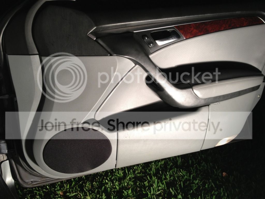

Some more/better pictures:
Stock:
Modded. I forgot to push the trim ring all the way so use your imagination:
I can flip the material around for a more textured look.

Matt! That is exactly what I am talkin about! The sound quality difference is going to be worth the non factory look and little less protection by far!
But I am more interested in exactly how you removed those pesky washers holding the trim ring on. If I could figure that out I would have cut that ish out already!
I had an issue with the armrest wanting to rotate to far back so I decided I needed some protection! Stainless steel grille in place. Door panel grill cloth next!

Over on DIYMA, there was a 9" put into a TL door without modding the panel. What it looks like it takes to make that work is mounting the speaker straight to the door without a baffle and it sits behind the door card. The Dyn 10" is only 3" deep so it will fit depth wise without a baffle.
This is the thread I'm talking about. The 9" in question looks MUCH deeper than the Dyn 10". http://www.diymobileaudio.com/forum/...-part-2-a.html
Here's the Dyn I'm thinking about sticking in there. http://www.woofersetc.com/p-5555-eso...subwoofer.aspx

That AT 9" is 4 deep too. You might be able to use a small spacer (1/4" or 1/2") just to decouple since the Dyn is only 3" deep.

Let's see if we can get a quantity discount form Jerry, 4 Dyn 10" midbasses. Then I'll sell you my 650 really cheap.
We are pretty lucky depth wise and on top of that, I haven't seen too many 10s that are only 3" deep. I would have looked into it sooner if I had realized. The only problem is the 650s already destroy the doors with 10.5mm of excursion. I can only imagine twice the cone area with 14.5mm of excursion. But yeah, nearly 3x the displacement. Those things should operate effortlessly.

Hey Pohljm, did you ever cut the factory grills out and replace them with cloth? I decided to cut mine out today while trying to fit these monsters in my doors:
(Exodus Anarchy next to X-65)
I pulled all the rivets off and cut out the stock grill with my Dremel.
Test fit:
I picked up some speaker cloth from the local fabric store and hot glued it to the trim ring and hot glued the trim ring back onto the door panel. It was hard to get the trim ring to fit back in the panel with the extra fabric around it so it doesn't sit completely flush, but it's not too noticeable.

I was waiting for someone to do that! After you get some listening time in, let us know your opinions on the change in sound, if any.

I did not! with the smaller 6.5 ID's I am running I loved the clarity with the panels off, but enjoyed the additional mid bass that came with the speakers blocked a bit and loading up on the door card. I think its a must almost for those that are running 8's and 9's in the doors. way to test it out though. Have you tried having the trim ring exposed and not wrapping the fabric? that may allow a better fit.
