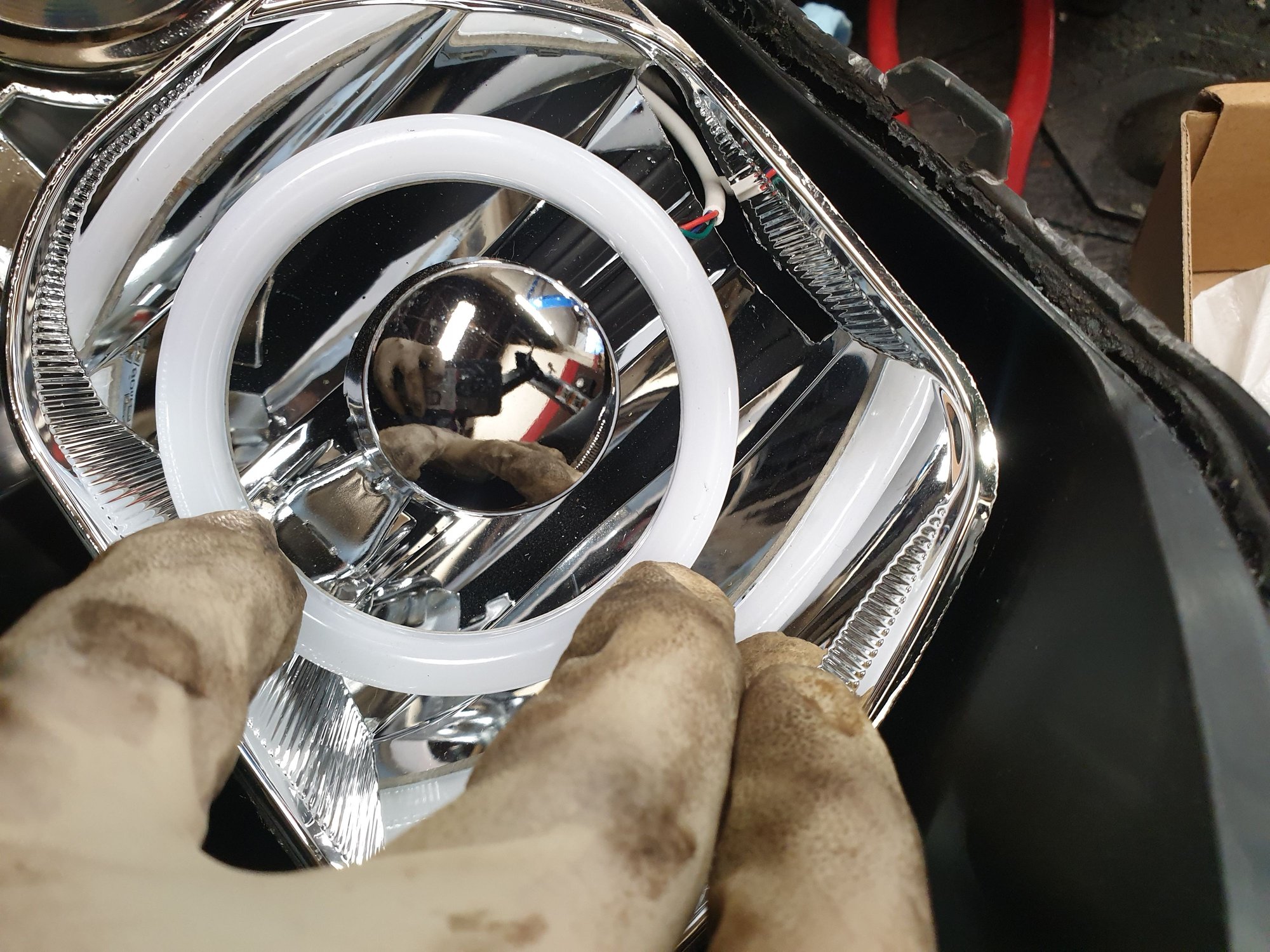

I did something similar to this, i did it myself and did all the wiring, I am willing to help and i actually have a few pictures. Few things before you get started-You will need to open up OEM headlights, i used the oven in my house to warm up the glue and make it easier to open
it will take a lot of hours so it will not be a one day thing
I purchased my angel lights on eBay, i will try to send a pic of which one it was when I find them, and i will send a pic of the lights currently on my car, 06 tl

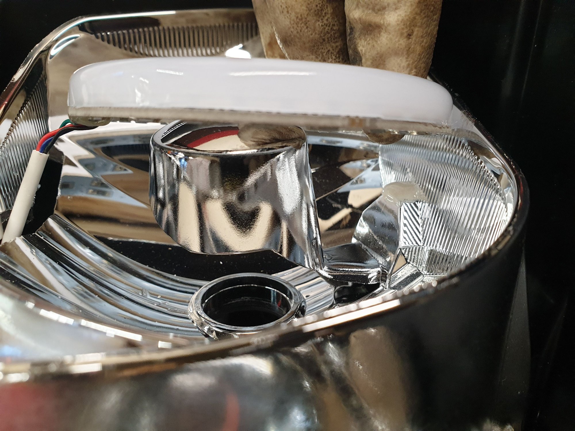

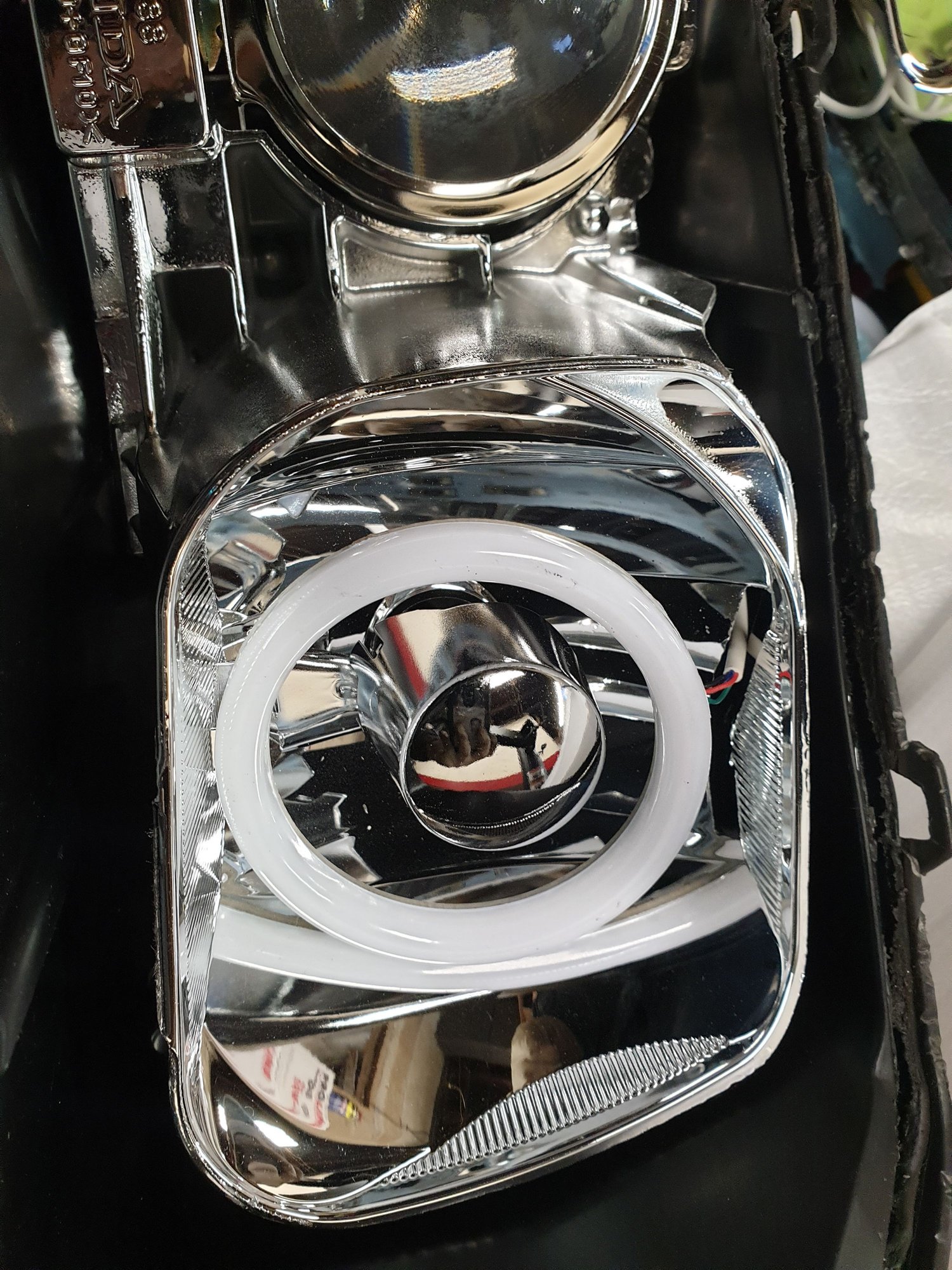

Found the led lights
Idk about the strip in the pic u postedz but this is how mine looks like
You can try finding others one that ship from the US but this one i ordered from China (1 pair for each headlight)

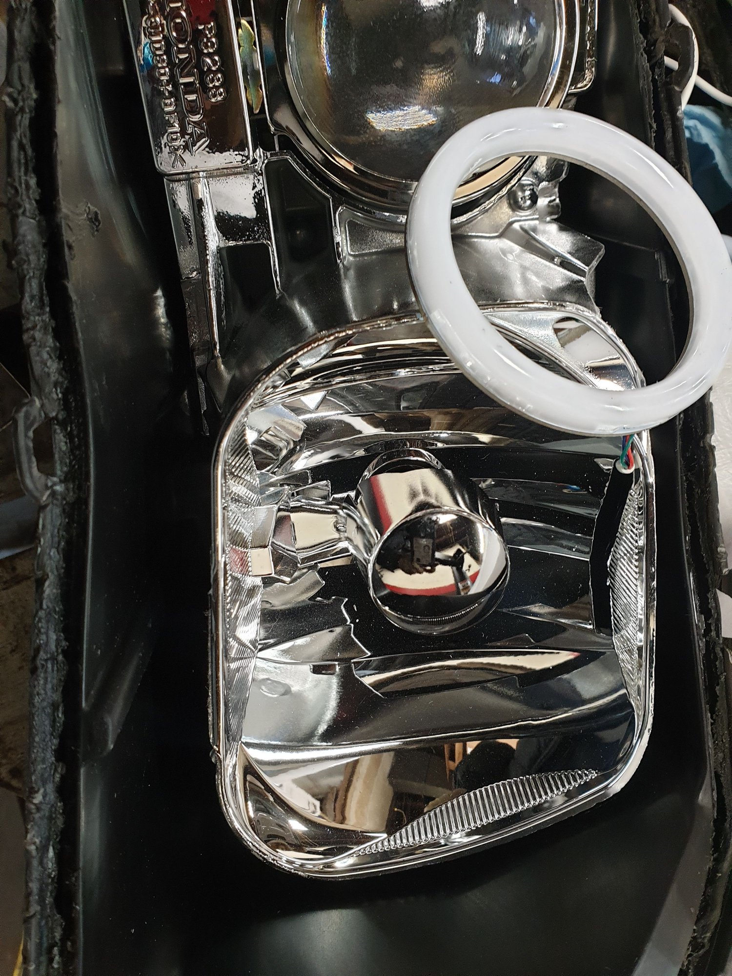

I can upload videos here right?

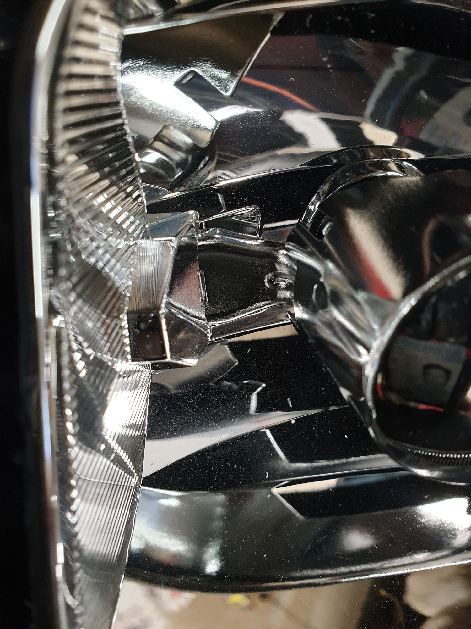

So that first pic of the headlight is after you open it up and that plastic piece i believe is held on my a Phillips and u can kinda see the circle part of it where one of the lights will go on top of, u will need to fill down and cut some of the plastic for it too fit back in the corners

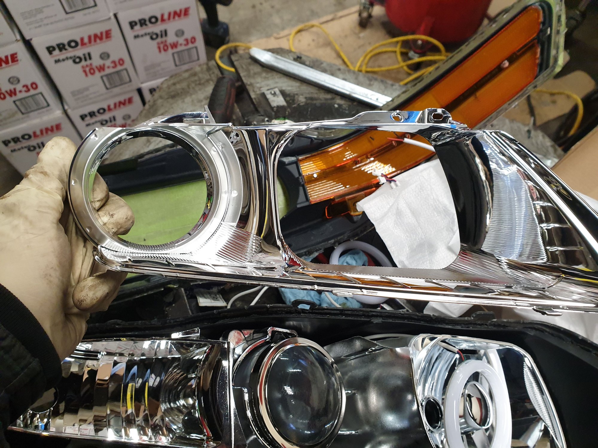

I have some videos that i took while i was doing them, and no only for the fog light i didn't have to cut anything i just glued it in place only for the low beam u have to cut a little bit to make it fit, how can I send u the videos? I don't think i will make a YouTube video just for that
