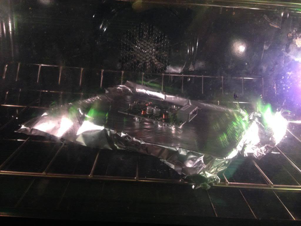

Well, the wife was cooking lasagna tonight so I said WTH, let's try the baking thing and I'll be danged if it didn't work. Took hooking it up twice tho so give it a few try's.

I actually pulled the board out of the black jacket and stuck it in the oven. 385F for 8 minutes followed by a 25 minute cool down. I then inspected for any damage caused by the baking and found none visible. Threw it all back together and in the car and now it's working again like a brand new. don't wast your $600 at the dealer for a replacement

I've read the baking & heating up fixes. I'm a electronic technician and been repairing equipment for 30yrs. Electronic components don't last forever and break down for different reasons. There is some slight truth of cold solder joints, and baking an circuit board appears to help, but it also may break down the actual electronic components on the board. One main rule for electronic equipment & components it doesn't like constant heat. I found the OEM part for around $200 on amazon about 8 months ago and had no problems. I understand about saving money, but if you get more than a couple of months with the heating fix which some folks has feel lucky.
Yea, I dont know how smart it was for Acura to put the Bluetooth in the roof console where it gets hot all the time from the sun baking on the roof!!

Here are my thoughts... I'm an electrical engineer with a lot of experience soldering, assembling, reworking, etc. PCBs. For several of my hobbies, I design and assemble PCBs in a toaster oven that I specifically outfitted for soldering, applying solder paste with stencils that I cut with my CO2 laser cutter.
My 08 TL had the same "booting up" problem, and the previous owner simply disconnected it. After a bit of reading, I saw several posts about the baking method, etc. I pulled my HFL board, inspected it under the microscope, and didn't see any bad solder joints on the joints that I could inspect. Unfortunately, there are 3 BGA chips, which you can't inspect with a microscope, and are typically the ones that have failed solder joints. BGA stands for Ball Grid Array - rather than chip legs, they have a bunch of solder balls underneath. To inspect them, you need to use an x-ray machine, which lets you spot cracks and voids in the solder.
The solder joints on these commonly fail for several reasons... one of them is thermal expansion. Many times it's the chips themselves that get hot and expand (like the common XBOX 360 and PS3 failures), but I believe in this case it's the car that gets hot, and the PCB and chip expand differently, stressing the joints, and causing them to eventually fail. As you'd expect, solder joints on smaller BGAs fail less than those on large BGAs, since there's more expansion and more stress.
To confirm what I expected, I plugged in my HFL, but left it hanging where I could access it. It said "booting up"... so I turned the car off, squeezed the chip large BGA chip, then turned it back on, and it started working. As soon as I stopped squeezing, it seemed to lock up. The two smaller BGA chips seemed to have no effect.
So, I pulled the board, took it inside, and reflowed the solder on the large BGA chip. I squirted a bit of no-clean liquid flux under the chip, which helps the solder to reflow properly, and then used a surface mount preheater, which warms the entire board up, and then a temperature controlled hot air soldering tool to reflow the solder on the BGA chip. Even though I used no-clean flux, I still cleaned what I could off the board (it's really hard to get all the flux out from underneath the chip, and no-clean won't cause problems if it's not 100% cleaned).
I popped the board back in, and it has worked perfectly for the past week. It's certainly possible that it'll fail again in the future, though I have no doubts that it's failed solder joints causing most problems, not failed chips. If I had access to an x-ray machine, I'd inspect the solder joints and see how they look after my rework.
My comments on the oven method - it's not the proper way to fix it, and not likely to work great long-term. Problems:
385F is only 196C. The solder is almost certainly lead-free, which generally has a melting point of around 217C (depending on the exact alloy), so that won't actually melt the solder. Most ovens have really poor temperature control, and may hit the melting point, but not in a controlled manner. For proper reflow, you should actually go quite a bit above the melting point of the solder (peak of around 245C or so), for a short period of time. You should also use flux, since simply melting old solder will create bad solder joints, which will likely fail again shortly.
Simply sticking the entire board into an oven isn't great, without proper care. You definitely need to keep the large and heavy components on the top, otherwise they will fall off, once the solder melts. Small components will hold from the surface tension of the solder. You also need to make sure the solder is no longer molten when you pull the board out, otherwise the parts will fall off. The large plastic connector is also unlikely to survive the heat of a proper reflow. You could desolder the connector, reflow the board, then resolder the connector... if you want to put a little bit extra effort into it.
8 minutes is also too long. A typical reflow is under 5 minutes, including a controlled ramp-up. Unfortunately, you're not likely to get that sort of ramp-up from a standard oven. The chips are fairly resilient to minor temperature stresses, so this isn't a huge deal (will likely shorten the lifespan of the components a bit, but if the board is dead... any extra life is more than it's got now).
Attached is a typical reflow temperature profile for lead-free solder, to give you an idea of what you're trying to mimic with the oven.

Originally Posted by DogP
It's also possible that there are several different failures that can cause the same problem... I've read some talk about a connector failure, and another about a capacitor failure. In my case it was the BGA, which I was able to confirm by squeezing the chip.
Pat
thank you for your analysis Pat, that all makes sense! i talked to a few electrical engineers (i'm a mechanical) and i tried to replace all the large capacitors based on a solution that works for some 04-06 HFL boards. I confirmed that just replacing the capacitors does not work for 07-08 HFL boards like it does for the 04-06 boards. so i think this gives a little more credit to your find on the issue (or one of the issues).
Old Jun 22, 2017 | 03:05 PM
  #75
DogP's Avatar
Joined: Jun 2017
Posts: 127
Likes: 83
From: VA
Yeah, I tested all the electrolytic caps on mine with an ESR meter, and they (somewhat surprisingly) all checked out okay.
Pat
