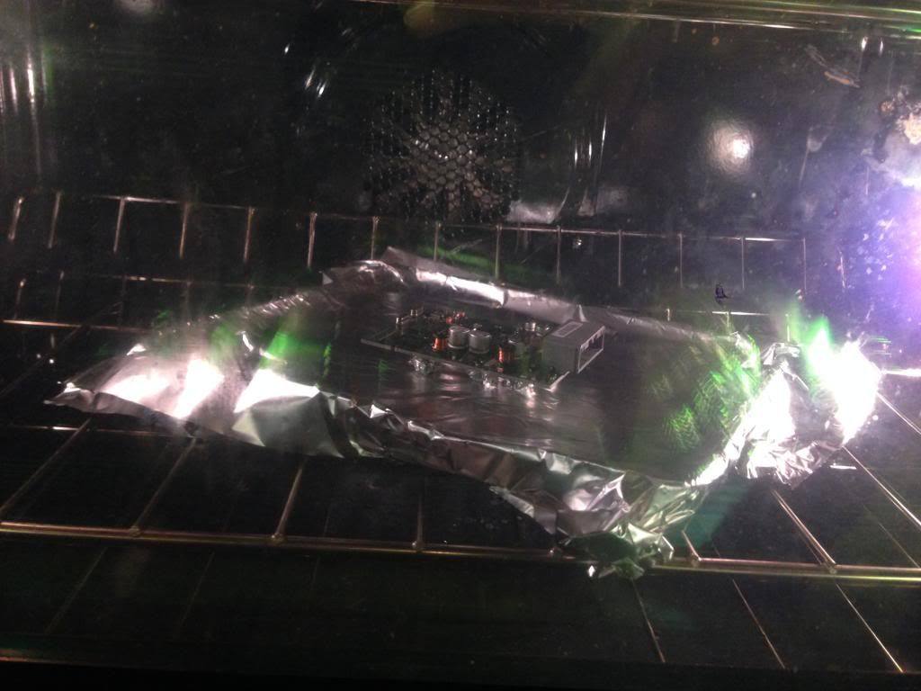

I have the same message. What I've learned is this message is an indicator that your HFL unit has reached the end of its life. What I've tried in the past is the "bake" method, where your bake your HFL unit in the oven. This method did temporarily work, however, once the HFL stops working, that message will appear. I will be trying the method one more time, but just know that if that message is appearing, your bluetooth is not working. When I have that message, my car's phone button on the steering wheel doesn't do anything either.

This is the issue im having. Ive baked it once already, worked fine for about a week. now it works now and then. I'll try baking it again, if no result i'll just disconnect it. Disassembly takes <10 minutes

I actually pulled the board out of the black jacket and stuck it in the oven. 385F for 8 minutes followed by a 25 minute cool down. I then inspected for any damage caused by the baking and found none visible. Threw it all back together and in the car and now it's working again like a brand new. don't wast your $600 at the dealer for a replacement

Jeedo6, you dont have to post your post in several different threads, one thread will be fine. If you read the threads we all know that you can back your HFL, but if you did read you will also know this only works for a couple weeks, at best. Plus, these are not $600, best price online is $215!!
