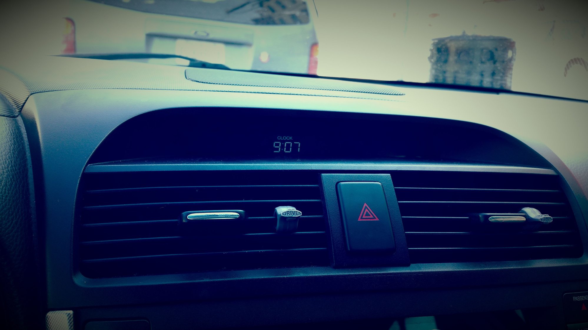

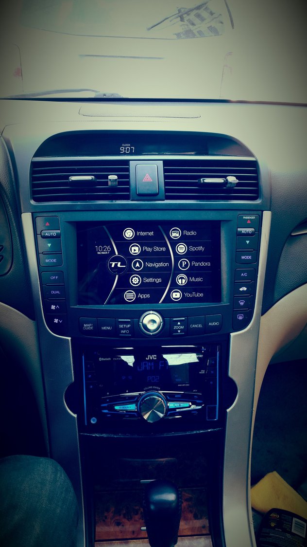

Hello im new to acurazine.
i have a 2004 tl which i had installed a nexus 7 and after market radio. I have a small problem where my clock is completly wrong and i really want to just make it disappear. But since i have a navi tl the clock cant be adjusted. I was wondering if there is any canle i can disconect or splice in order to make it disappear please let me know if you have any idea. or suggestions.

I ended up juat unplugging the battery and pluging back at 1 pm and its all matching now. But i generally just wanted to completely make it disappear. Now i have a clock on my tablet, radio, and the dash.. lol dont need 3 clocks imo
Lol you forgot to mention your phone hahahahha
Well i guess you will never be late to see your gf or pick her up... she will be pissed if your late... lol I have a suggestion, set all of them at a different time, than you have a excuse why your late... just tell her that time was little off...
Not to kill the topic, but thank you for all the info guys. I will be removing my stock radio and this is gonna be a pain if it sows a wrong time!
Thanks for the great info and all the tricks that all of you have done.
