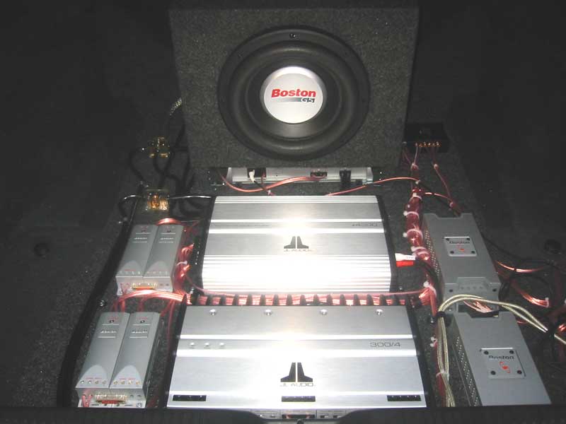

I have a 1 x 10" setup. I'm using the Boston G510 which is a pretty crazy sub and I have tons of bass and I'm happy. I'm firing into the trunk and it sounds great.
Here's what my setup looked like before I swapped out the e4300 for a 500/1:
