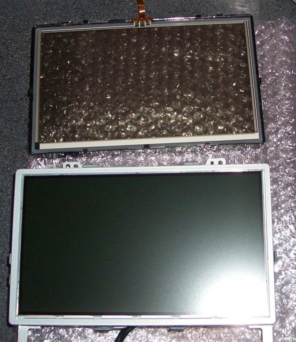

Alright I finally got around to taking apart the factory unit. It is made of some quality parts. I took some high quality photos so anyone else on this adventure can benefit.
You can view the entire 70 image album here. https://imgur.com/a/r5gSV
The images are still loading. I am off to do some research on all the new part numbers I found. I will update with more information once I do.
