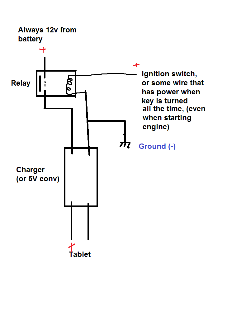

2. Something like that (paint hero) :
3. Some battery/capacitor and logic board and relay thing to keep charging the tablet even if there's no power. Probably too complicated.
Thanks! I figured I could just run an add a circuit to the ecu fuse or something that stays on during start and have that trigger a relay for the radio. I like the feature this vehicle has though where itll keep the radio on even when you remove the key until you open the door and Id lose that but its not a terrible loss because I dont usually sit around in it very often anymore like it did back in college or something.
