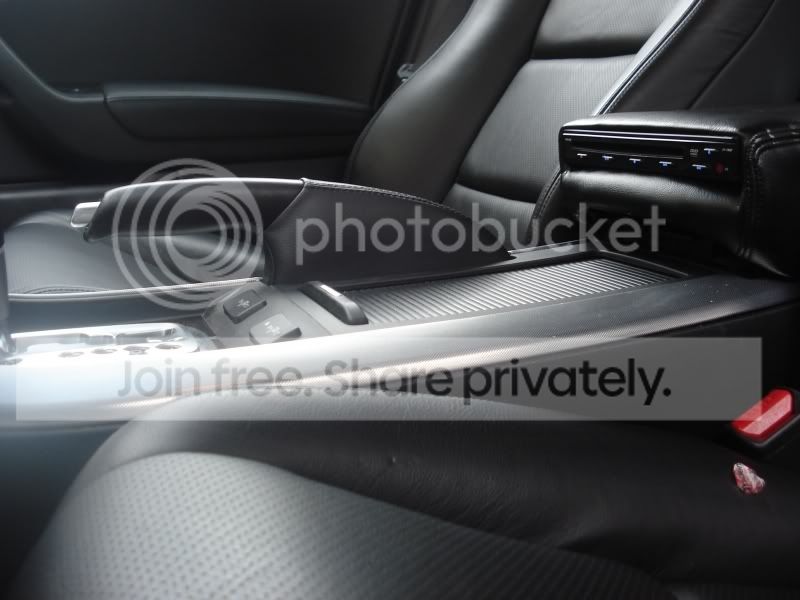

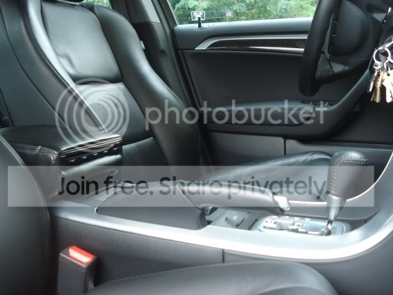

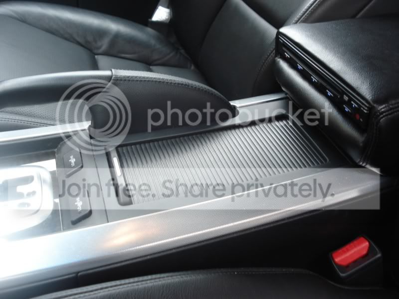

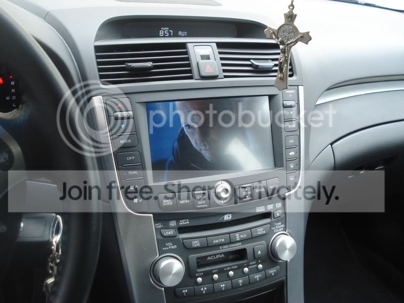

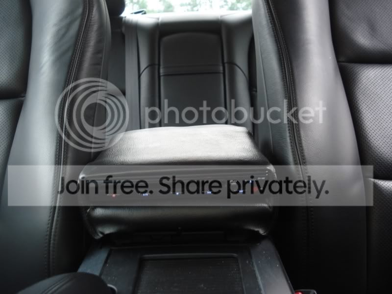

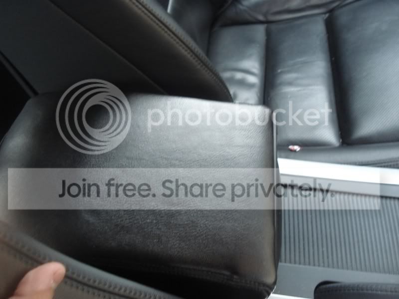

So I bought a DVD player and put it in the arm rest of my 07 TL w/ Nav. Plays great using AUX inputs underneath. I retained full funcitonality and use of both compartments underneath and I have been witness to absolutely no skipping or overheating whatsoever, even on a 4 hour southpark marathon. Works great...
Had it in for about 2 months and haven't had a problem yet. I hated the idea of having to go to the trunk or back seat to change a DVD so here goes.
See pics.
passengerview
DriverSide View
Watching 24 season 5 dvd
Top View of ArmRest
Another Side View.
Front View of DVD mounted.
Also, I lean on the thing all the time and couldn't be happier about placement and usability. Haven't seen anyone else do this yet but I haven't been on the site in a while either.

Do you seriously have a cross hanging like 4 feet from your rear view mirror?
Nice job - personally I like the half din setup in another thread on here; my fear would be leaning too hard on the arm rest and the increased risk of a break in because it's easy to see.. but nice work!

Funny you should mention.
I honestly forget that the cross is even there unless for some reason I stop short which is not very often, because when I do, I notice it and the cross swings into the windshield a couple of times.

I took advantage of the fact that the 2007 TL w/Nav came with aux input right next to the car adapter in the bottom compartment.
The Audio is plugged into the aux input in the bottom compartment along with the power going to the car adapter right next to it in the lower compartment.
The Video is wired out to the trunk along the passenger door sills in between the seats and the trunk pass through.
The armrest is about an inch higher than before but I didn't notice a difference in my arm position and I lean on it just like I used to.
The reason I didn't take pics of the install yet is because I still have an "I.R." extension to position so I can control the remote more naturally. At the moment I use the ir on the face plate to fast forward, reverse, pause, play and stop or I just press the buttons on the face if I'm really lazy or can't find the remote.

Well I thought of that earlier on during my planning of this but realized that any mechanism that provided the slide/fold would add more height or possibly width to the armrest which I didn't want to do since you already have to automatically add height for the player. I think if you pushed the payer far enough back into the armrest it may be feasible without much additional space required but pushing of the buttons and maybe even aesthetics may be compromised.

When I pulled the player out of the package I immediately placed it right on top of the armrest and it was a perfect fit within the outside seams. So the only issue would be adding an inch or so up on the sides to accomodate the unit and its wiring. A metal housing was inserted first so that the dvd player could slide into that once the cutting and sewing was done. Padding was added to the rear behind the dvd player so that the top rear of the armrest was still smooth and flush and not hollow inside which would have looked and felt hideous. That's pretty much it. Sorry, I didn't take pictures of the upholstery work but there wasn't much to it once the concept was there.
