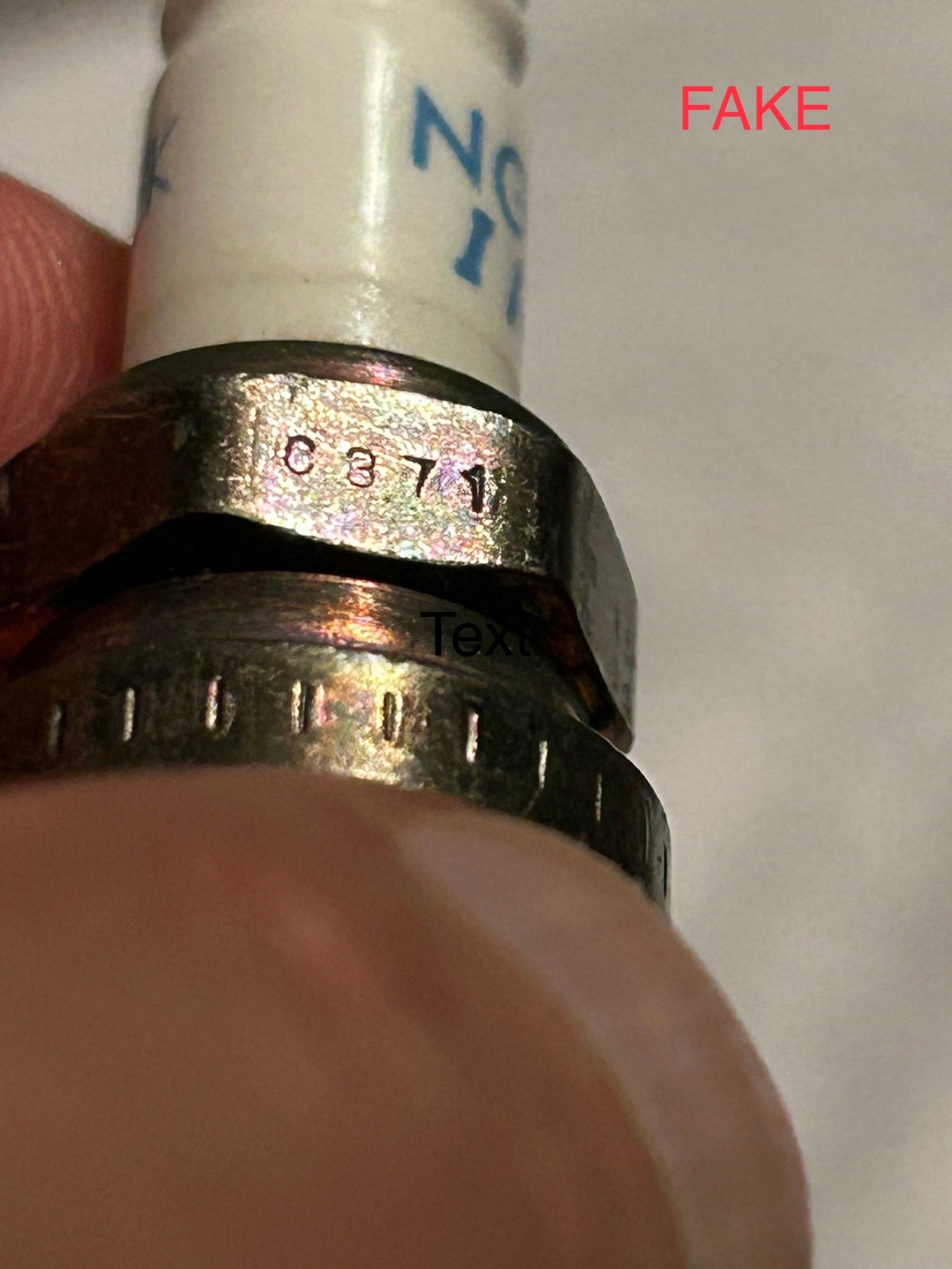

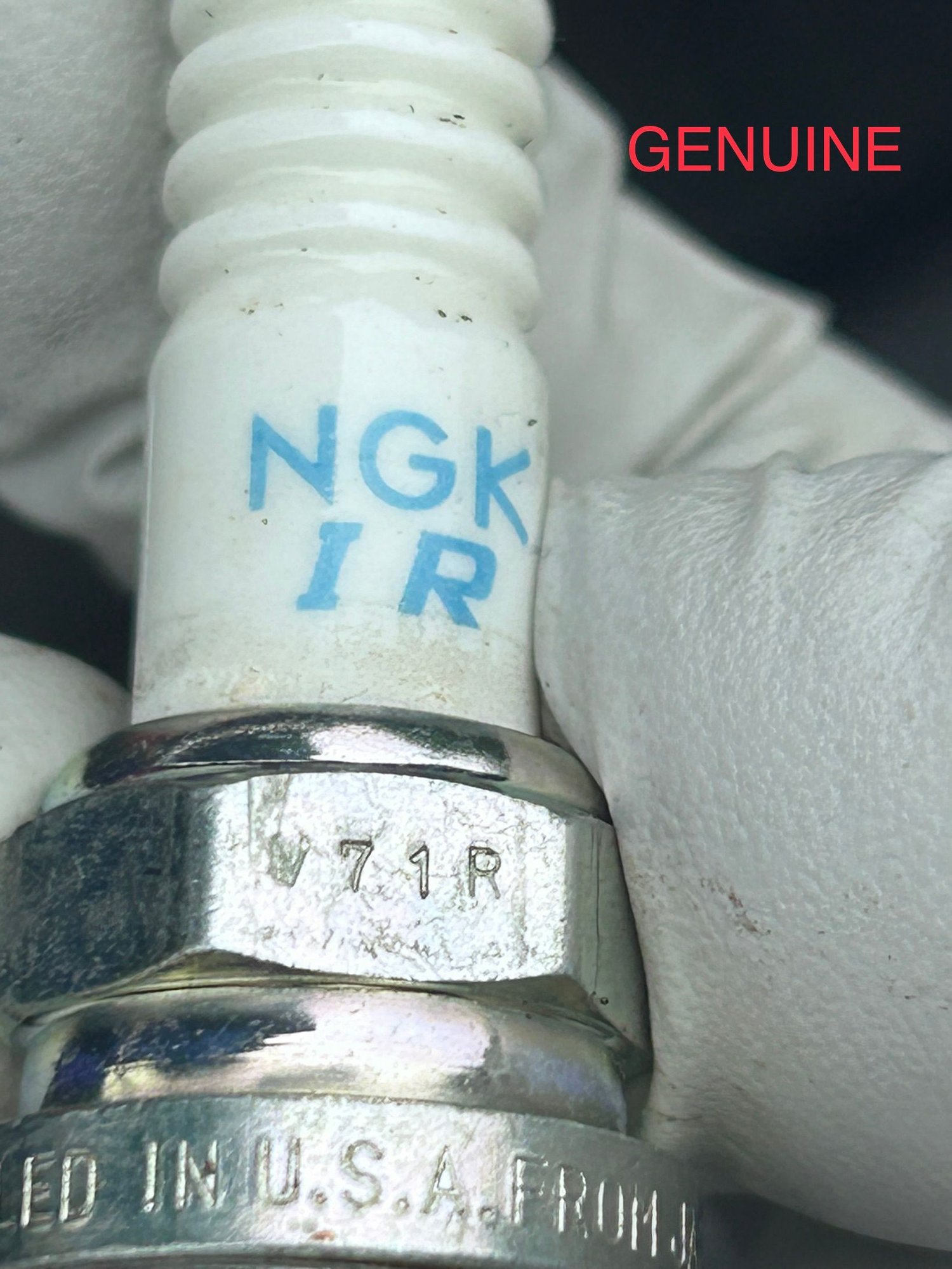

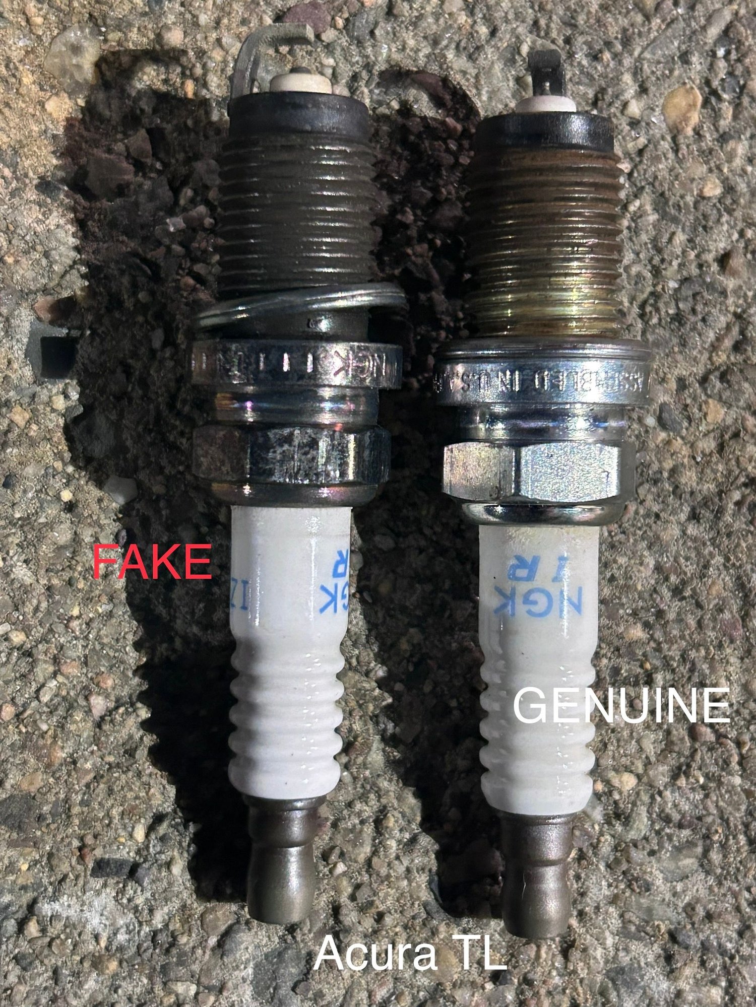

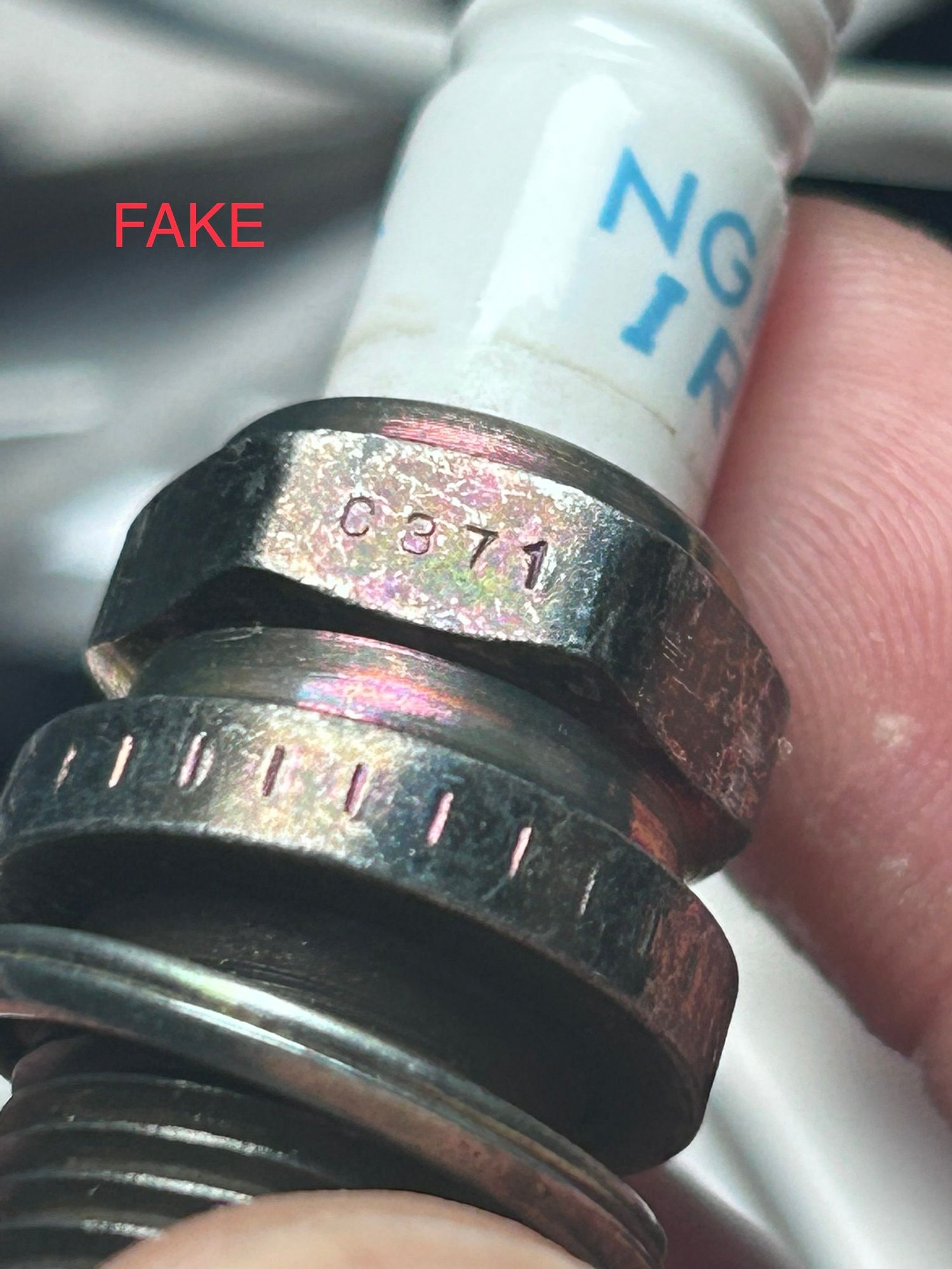

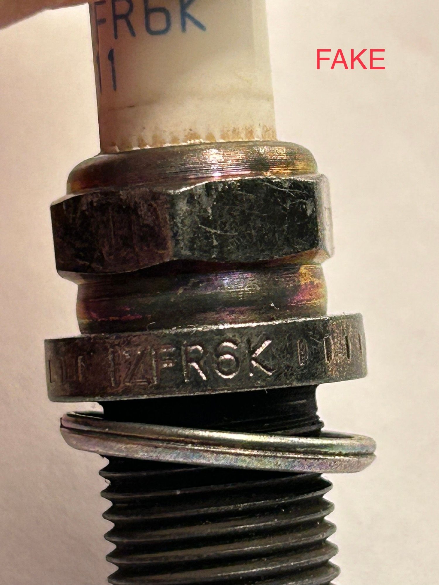

A while back I ordered 6 NKG spark plugs from Amazon and installed them and they ran fine and after 6 months later removed to check them out and found out one of the spark plugs the tip was completely rounded and went online doing some researches and it was a counterfeit. The other 5 are genuine.
here is the counterfeit compared to the genuine ones: note the big gap between the washer and thread on the counterfeit and the thread on the counterfeit is rough, the genuine has smooth thread.
