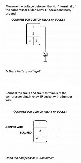

Not so sure I would have blindly dumped in a can.... I'd do the AC clutch jumper test to rule out a bad AC compressor clutch.
Car off and keys in you pocket. Pull the AC Clutch relay and make sure there's battery voltage at pin 1. If not then fuse #12 may be blown. If there is voltage then jumper pins 1 and 2. If you hear a click at the AC compressor then the clutch is working and there's probably some other issue with the A/C. If no click then it could be a bad wire to the clutch or more likely a bad AC clutch/field coil.
Also - after the jumper is out and the relay is back in - with the car running, if you try and turn on the A/C do both fans behind the radiator turn on? If yes that further points to a compressor clutch issue since the fans usually will not come on if there is a system charge issue.

^^^^ This, and OP, are you sure he replaced the right relay?

Another A/C mechanic said he tried to manually jump the compressor to the batter but it didn't turn on. All signs so far are leading to replacing compressor. I managed to buy a Murray a/ compressor at Oreillys at cost of $160. The manager was hella cool with me there. Not this weekend but next I'll install it in myself then post a reply. I'll give an update if the compressor fixes the problem
