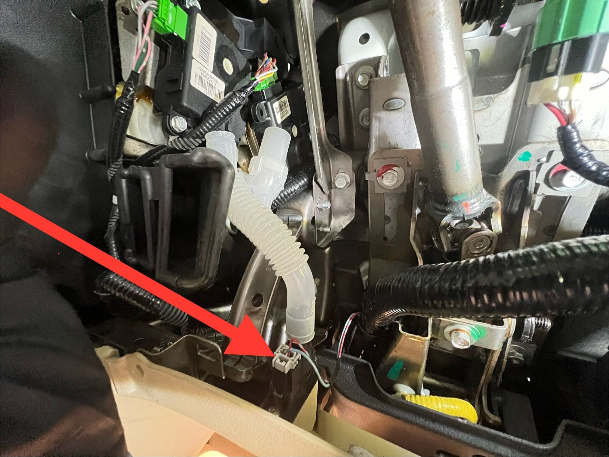

I tried to remove the black plastic panel covering the steering column and think I disconnected a couple of parts.
What is the electrical connector in the first part? And what is the corrugated plastic tube for?

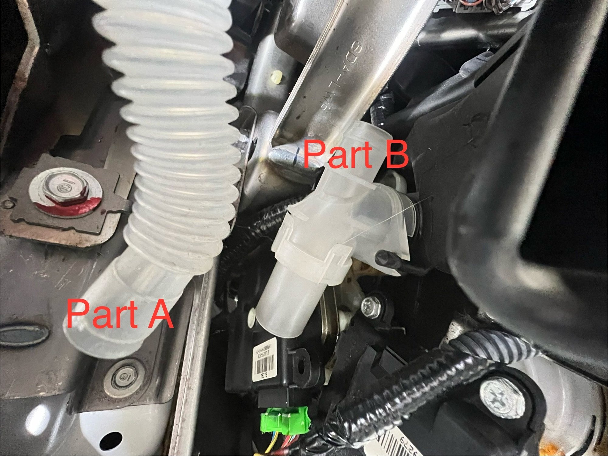

For the second photo, I assume that Part A fits into part B, correct?

In-car temperature sensor.
That tube sucks air, into the sensor.

Thank you! That's kind of what I thought.
