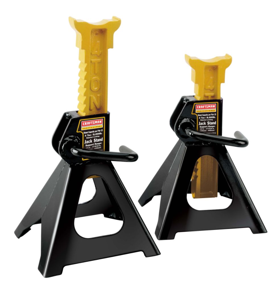

Last time i did it i used my ramps in the back raised the front and supported with craftsman 4 ton jack stands, which i borrowed and then returned after the install . Well anyways i have the 3 ton one myself, for some reason i dont know if they are safe enough when raised 6 notches up or pretty much level witht he rhino ramps. when i look at them, the arm doesnt look straight really. Im gonna leave the car on them tonight. and start working on it tomorrow.
Should i be concerend or can you guys recommend me some safety tips cause im gonnna be working alone on it. No warnings or help
Maybe i should just go and buy the 4 ton pro grade from craftsman...

Im gonna go and buy the 4ton pro version for extra support. $30 is worth feeling safer. Inaccurate do you recommend using the 4 ton as main support under the frame and then the 3ton along the side just in case or vise versa?

The Pro 4-ton is the same set that I use. I recommend using four quality stands, one at each corner of the car.
Position the rear stands perches (this is the curved groove in the stand head) under the rear sway bar mounts (the u-shaped metal strap with rubber inside holding sway bar in place). The u-shaped metal strap is located (in general) in front of the rear mufflers along the under carriage. Lower the car while carefully positioning the u-shaped mount to be centered on top of the curved section on the jack stand (perch).
Position the front stands perches under the front aluminum subframe in front of the front tires.
I would place the 4-ton stands in the rear because the 4-ton stands probably have a wider base. The rear stands will be retracted higher to reach up there. Being higher, the wider base is important for lateral support to resist tip-over. Whereas the front stands are not retracted much and need less support from a wide base. Both 3 and 4 ton stands are more than enough to support either the front or the rear of the car (from a load capacity point of view).
The jack can be used as an additional secondary support. If you are using a hydraulic floor jack, leave the jack under the car (along the designated lifting point) with a small amount of load on the jack. Do this only after you have lowered the jack completely to verify that the stands are sound. I like to let the jack down a bit fast so that the car slams onto the stands to test the stands under the slight slam impact of the lowering car. This is how I always do it too.
As a reminder, remember to look around the house for something that can be used as a secondary support as we discussed. You want something very wide (for example, 2 or 3 feet diameter) to place as close to you as possible while you are under there.
The secondary support is there as a back-up plan. For example, what if someone drove into your driveway and bumped your car while you were under it. The quality stands will not protect you. The whole car would tip over on the four stands and fall on you. Whereas the wide piece of junk that you found in the back yard would had saved your life. This is just food for thought.
