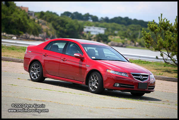

Update: A little more playing with the tires and the cah goes straight now. Plus, it feels 100x more stable. Curious as to what happens when the tires get rotated. I'll definately mark them as to which was where and see if the fade comes back afterwards. That is a ways away though.
I got a free water and 2 mints!
Wash & wax to come this weekend. Moleskin is here, so that will need to be applied. Phone call is in order to get tint appointment.
Gratuitous phoot:
