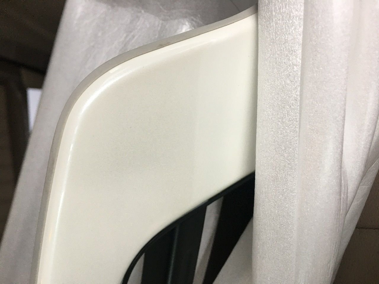

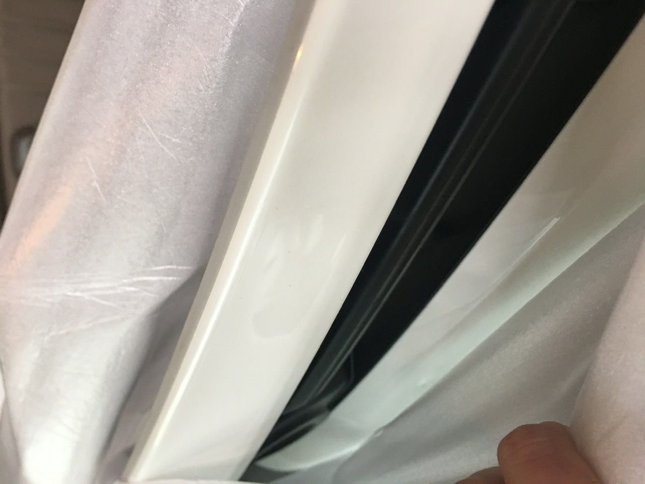

I just picked up a new Aspec front lip for my KBP but it’s white. The rubber surround is gray. What color is it on the factory KBP painted ones?

That was lightened by the sun. They are all black, P/N 08F03-SHJ-1100D.

The one I bought is brand new. I just got it today from EndLessRPM. It’s still in the foam wrap.

Replace the gasket with a black one, which is the part number gatrhumpy provided.
I replaced the black gasket that came on my NBP lip with a grey one.
I called around with the Honda part number to multiple dealers here in Canada. Turns out their system here doesn't recognize that part number so they couldn't get it.
Ended up going with one from Toyota.
Grey - PN 76875-06020-B0
Black - PN 76875-06020-C0
To me the Toyota one was better quality. A bit thicker and stiffer than the one from Honda

OEM in KBP is black. I am not sure if you can see the rubber piece zoom in lol.

Thanks to all of you for your input and part numbers. I was worried I’d have to paint it and it would start chipping off.

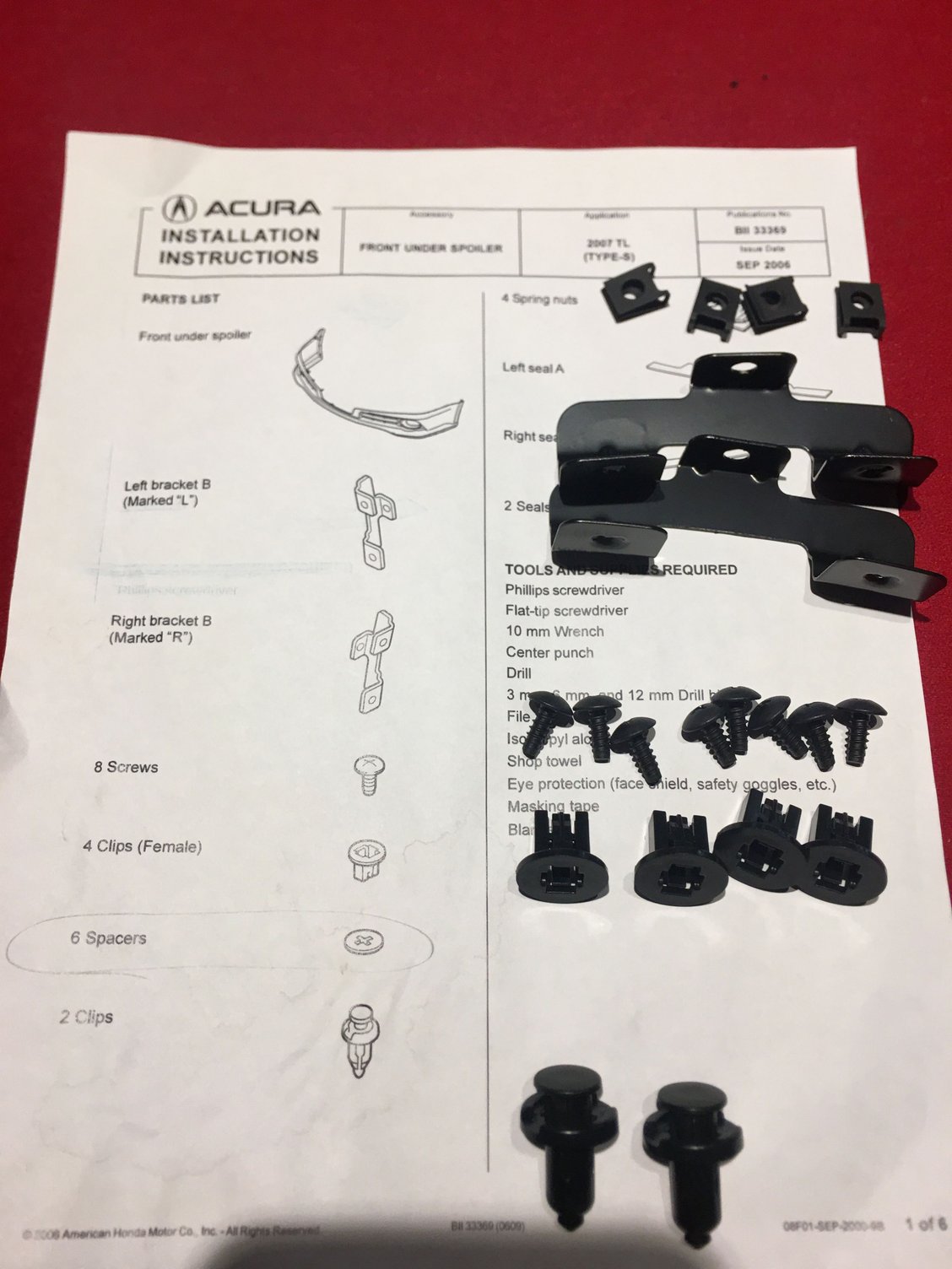

I got all new hardware to install the Aspec full kit but the part that looks like a circle with a plus symbol was not in the front or rear kit. Does anyone know what they are?

Not really sure what your referring to, Is that the template for where to drill the rear bumper? If so, I remember that they are actually molded into the backside of the bumper cover for the drill points

The spacers in the instruction sheet.

I believe those are spacers to get everything in alignment if needed. I do not remember using them

Update! I realize now this is a kit for 2007 and up. I do not believe the spacers are in the 2006 and prior kit

I have an 08 and guessing I’d need them. Trying to determine what they are. Foam or plastic and how thick. I can make something once I know

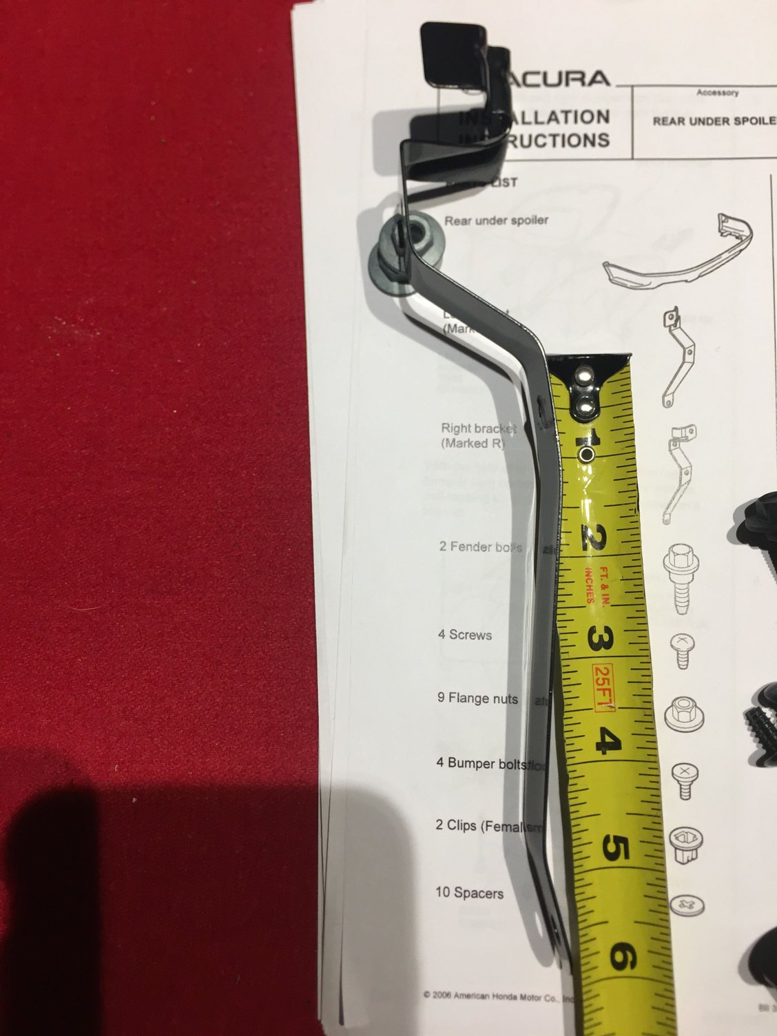

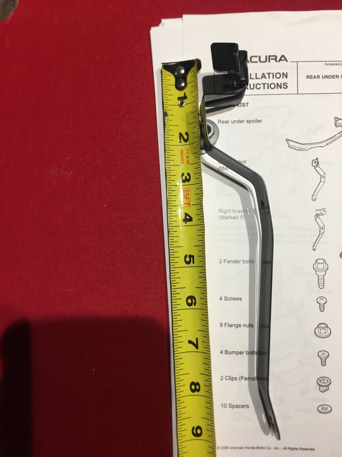

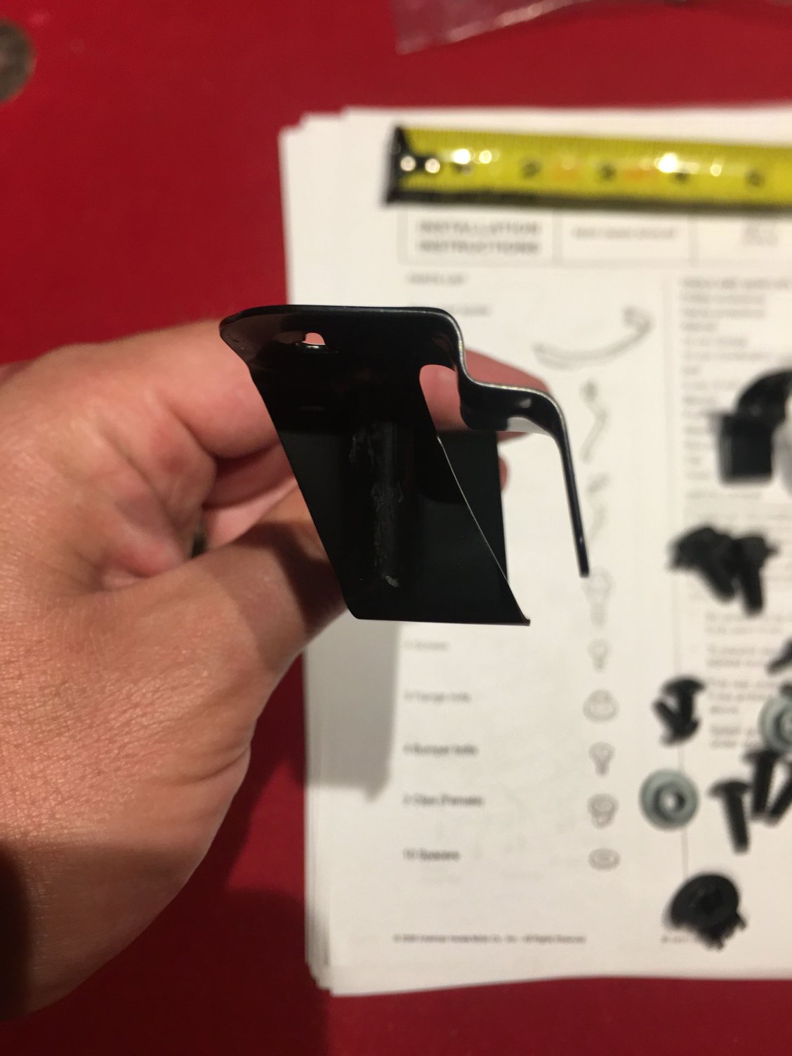

do you mind send me a dimension for the rear bracket? looks like I will be need them as well, thank you
Sorry it’s been a bit. This is just one side. The other is just bent opposite. Hopefully this helps enough.

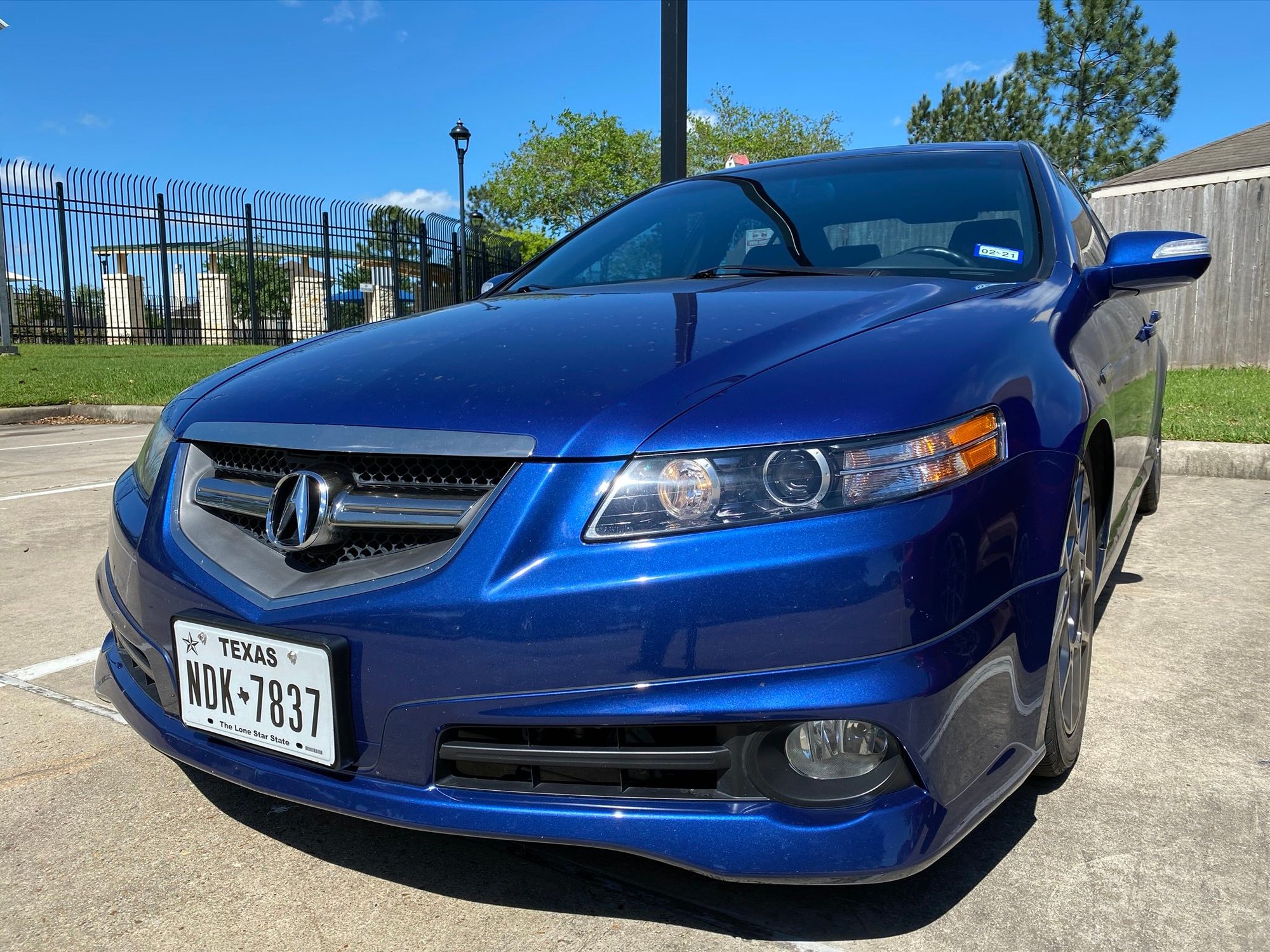

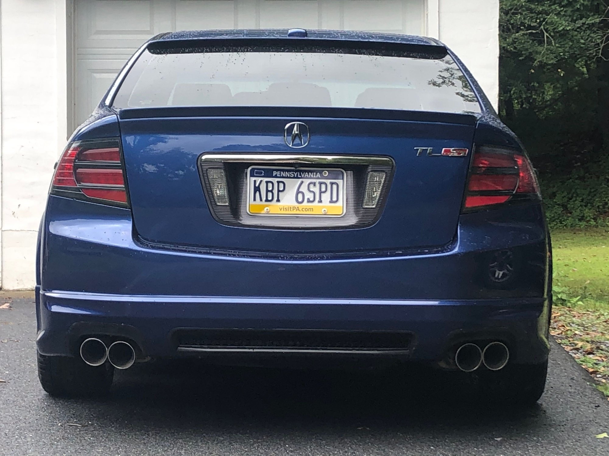

Finally got the kit on my car...

congrats, I know the feeling when mission accomplished.

lol what a rollercoaster of a thread. glad you found the brackets. I've told people to just bend their own with some metal.

Congrats on getting the A-Spec kit installed successfully. To me, 3G TL's look too bland or naked without the full skirt. It's a must to me.
At this point, I wonder how much additional value it adds to a TL since they're getting harder to locate.
