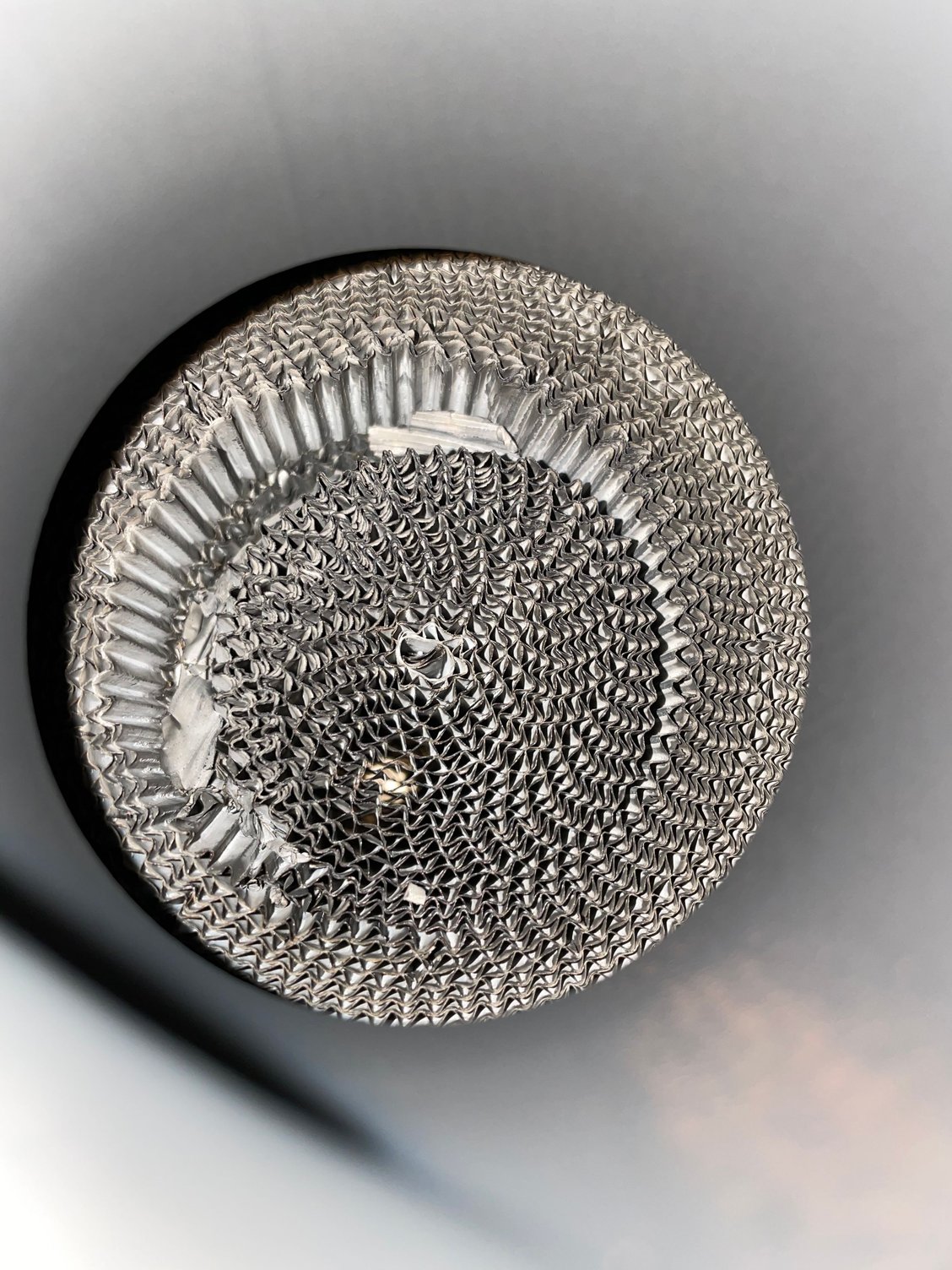

I haven’t even had my RV6 HFPC for a year and both banks have failed. Completely shocked because my oem cats lasted so long. Anyone else have this issue?

This is quite a common failure with the RV6 HFPC's; every year I see a couple posts like this.

yes it happen quite frequently, this is the reason why I would left mine stock.

Happens more frequently with boost.

need to use pro-cats if you can find them. mine been going strong for 13 years

Why is it shocking? They're aftermarket cats and they cost a fraction of the price....

The aftermarket construction is circularly wrapped vs. a solid honey comb that sits in in the cat. Pipe.
overtime, the gas pressure pushes the wrapped material out which loosens the grip on the pipe walls. Ending in failure.
The cat. material is also soft and made if non-precious metals.

while I didn’t expect the same quality as oem, I at least expected them to last a few years. It’s been about 9 months.
